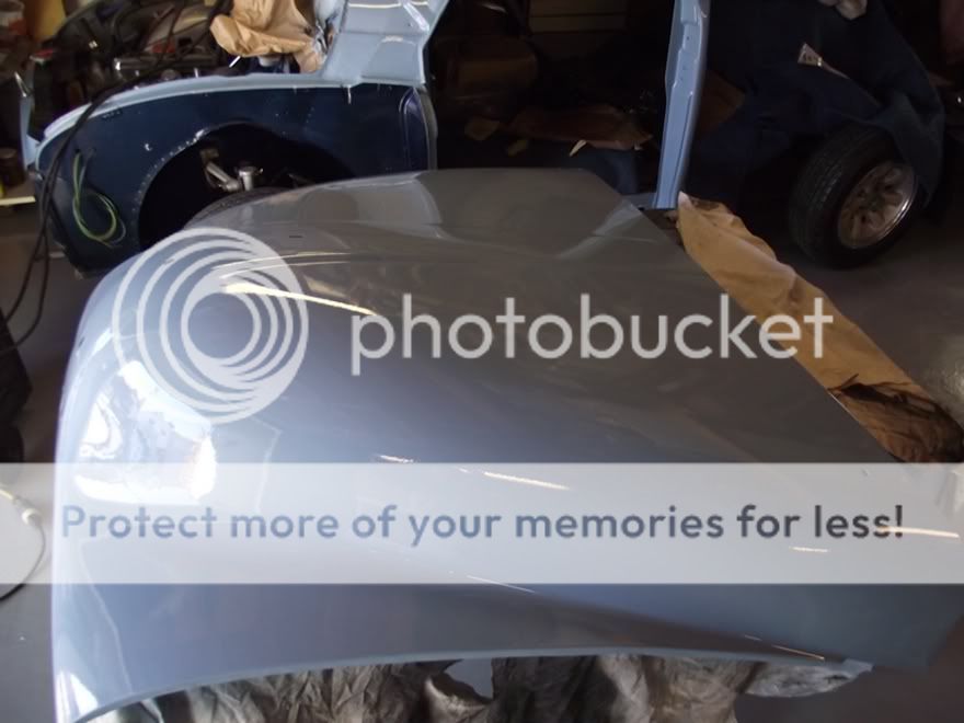

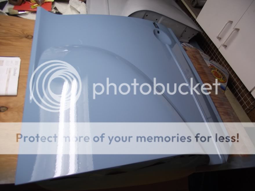

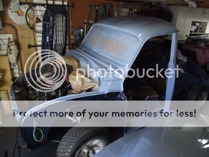

Gerard, that is lovely. I think the fresh painted bodies are super stuff.
Iris Blue. Mixed by correct color code. I got lucky and found the correct BU12 formula for the brand paint I'm using. Probably looks different on various screens though. It's lovely in the sunlight.
I liked it so much that I'm doing my Morris Minor pickup the same color. These a pre-sand and polish.
