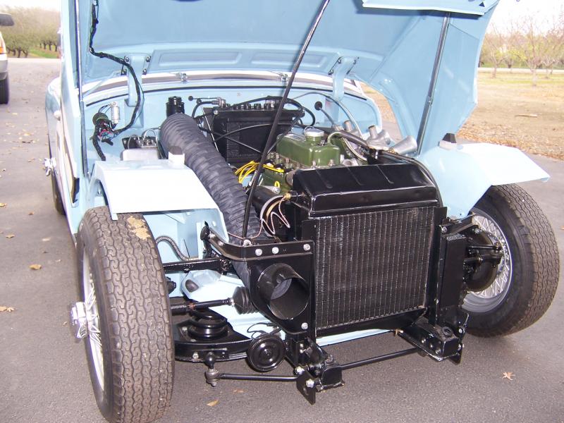

I've got to put my prop rod back on the Bugeye, but it's been so long I can't remember how it goes (both up position and stowed position).
The usual suspects don't have pictures/diagrams and I can't find any pics online.
There is a clip in the nose section just behind the grill, but I can't imagine what that is for.
Advice or pics appreciated.
Fred
apbos
attachment.php
From Butch Gilbert's Sebring Sprite.
Regards
Paul

I know this thread is a bit old but I just happen to be looking for this information and Google found it. Would it be possible to get a picture of the other end of the rod, where it is suppose to rest on the bonnet? And maybe one of the rod in the stored position? I would appreciate it.
Cheers,
Ric
'60 Bugeye
