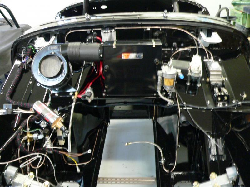

I'm getting ready to install the clutch hard line in my Bugeye and would love to see some pictures of what y'all have done. My current plan it to install a hard line similar to an MGB with a flex line from there to the slave. Thoughts?
Thanks, Rut
I just rolled a 360 deg. loop in the tubing to dampen the worst of the vibrations and connected it directly to the slave cylinder. Been in use for over 10 years now with no problems. But I must admit, Blue Max's solution is much more elegant.
