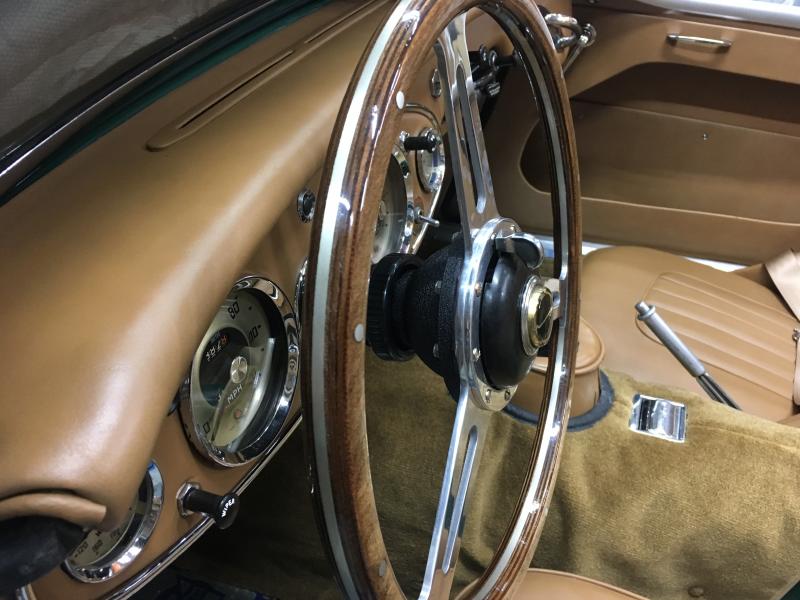

there is a lip inside the boss that is flat and the screws come in just in front of this lip. the backing plate is up tight against that lip.
adjustable steering column so i can pull the boss out or push it in. the distance remains the same which made me thing it was not an issue with the stator tubes. but again, i may as well give it a shot. i could certainly be missing something.
thanks for the suggestions.

i thought the small tube went inside the lower tube? but i also measured the distance to the lip the backing plate will hit. i am pretty sure it is in all the way... as far as it will go anyway.
Easiest way to tell is pull the steering wheel toward you (away from the dash). If the gap closes, it's not the steering wheel hub, but the lower stator tube. If the gap doesn't close and the trafficator moves with the wheel, it's the steering wheel hub..
John
Exactly my point above. I can pull it all towards me and it still does not change.

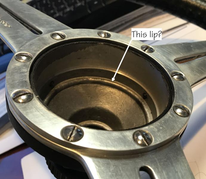

This Lip?
On mine this lip is 1 3/16" below the rim of the boss or 1 1/4" below the top of the steering wheel ring.

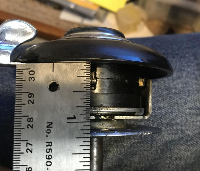

The depth of the trafficator is 1 1/4":

yes, thatis the lip i am talking about. i am pretty sure my trafficator is also 1-1/4" like yours. i measured that already and i know the original boss is 1-1/4" from the 3 flats to the rim. i measured my new boss and i do not believe it is as deep as yours. but i want to measure again.

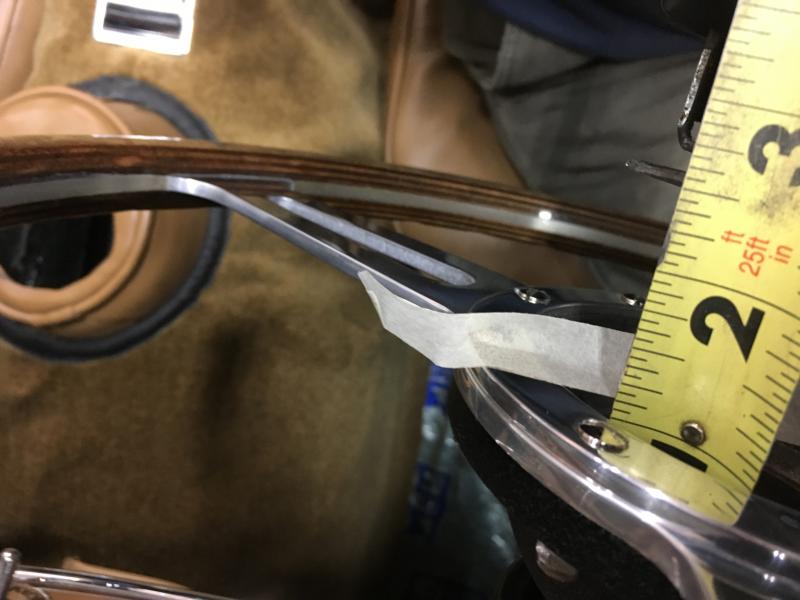

depth gauge says the lip is 1.1215 from the outer edge of the steering wheel plate. the cover plate actually sticks out a little more than the boss. i tried to take a picture. hard to hold everything so i iused tape to make a line between the sides of the wheel. it shows between 1-1/16 and 1-1/8 inches... which is what the depth gauge shows. so doing the math, i have a little over an 1/8". i have tried to send them an email to question it, but nothing seems to go thru for me. i keep getting an error that says they are aware of the problem and are working on it. maybe tomorrow i will get a chamce to give them a call.
You and John T have clearly demonstrated the manufacture of the part is defective.
