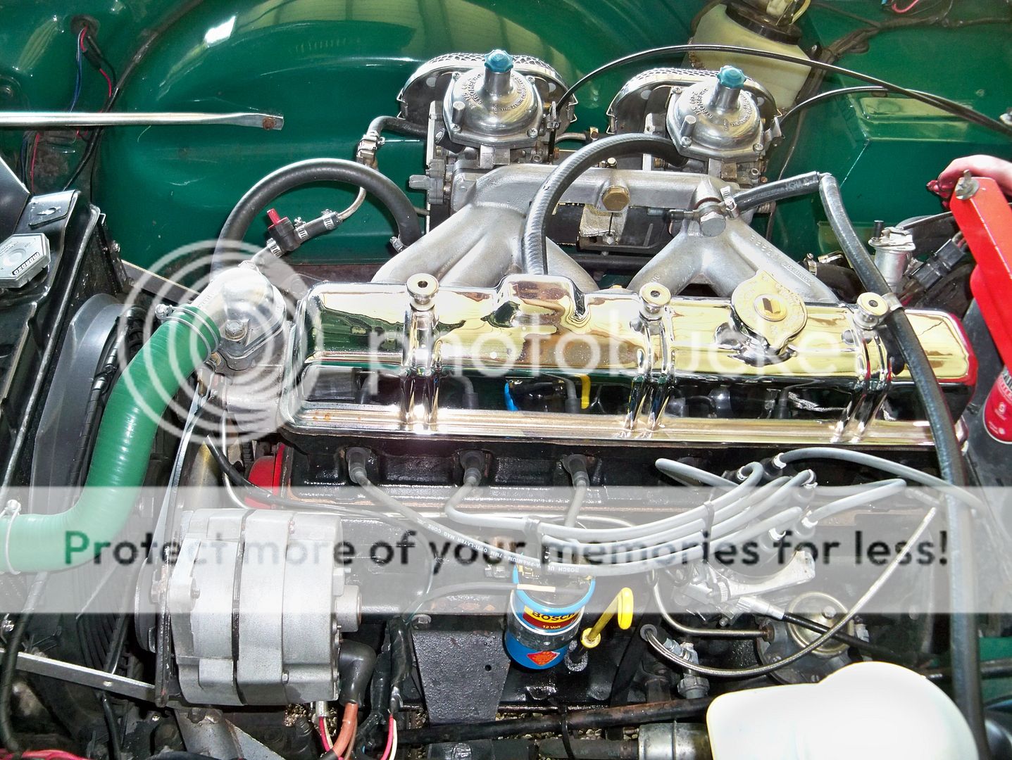

I got rid of it. I know it was a long post that I linked to, but read thru it and you'll see that was the ultimate solution. It's not needed.
In fact my engine plumbing is a lot simpler nowadays
That looks nice and clean. Unfortunately, I am running SU's and they don't have a port. I could run it into the air cleaner though. I'll have to take a look.
