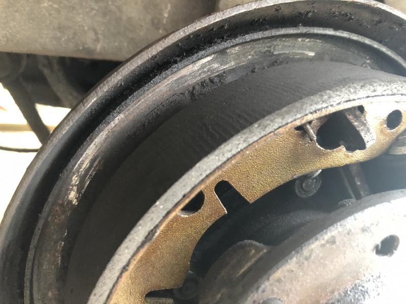

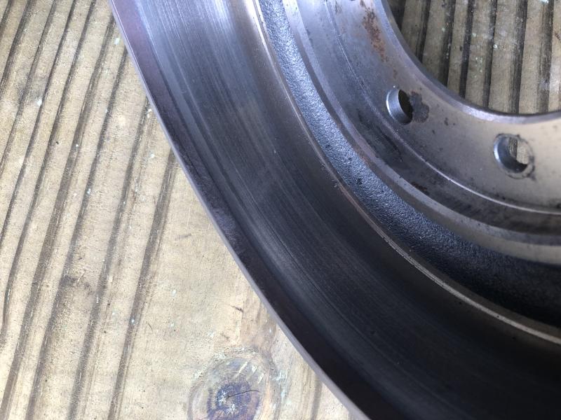

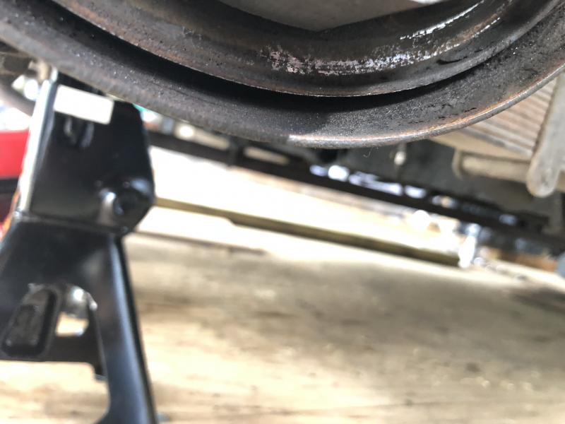

Ok... so I pulled the back drums to day to see if I can spot the grinding / rubbing spot. I think I can, but I'd like you guys to look at the pics...
So.... In the pics you can see some scraping marks on the back plate... and I also tried to get a pics of the edges and inside of the drums. They've taken on a somewhat purpleish color.... I'm not metal expert, but doesn't it look like it's gotten a bit toasty? These are pics from both sides.... both were pretty tough to get off the hubs even with the adjusters back all way, way off. My analysis would be the drum is scrapping on the back plate... I had them cut down to match the old ones, but maybe they just need another 1/8 or 1/16 taken off.... like an idiot I threw out the old ones... duh. I can't really see any other scraping points?
Whatcha' all think?
The axle flexes more than you might imagine, so even if it doesn't rub when going in a straight line, it still might rub when going around a corner. I'd scribe a line about 1/16 from the edge and grind it down to that line.
