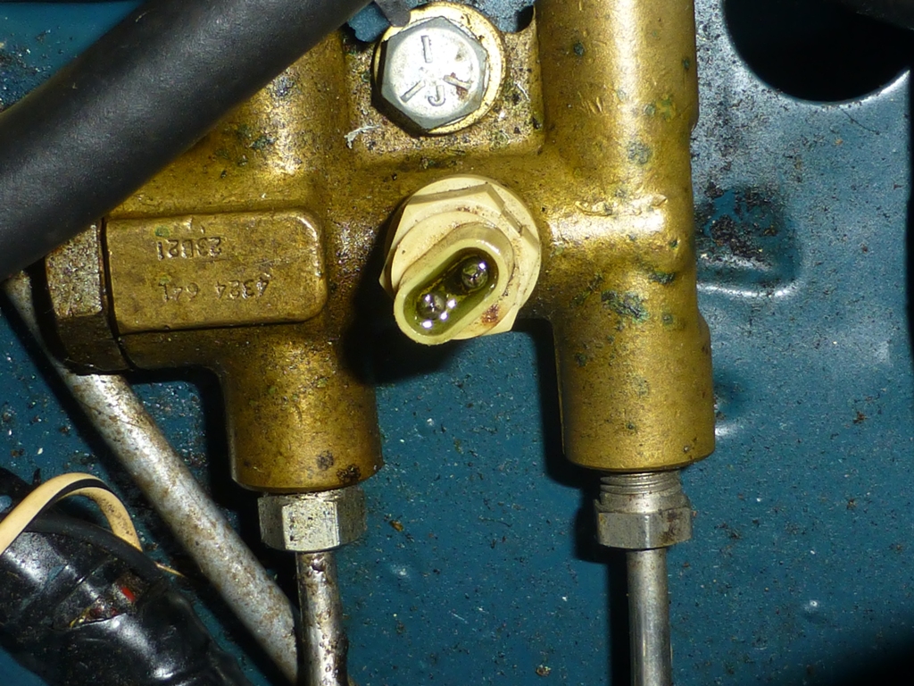

One more thing. I removed the nylon switch on the top of the PDWA and it looked dry Inside. It fits into a very tiny hole in the PWDA, I couldn’t see any valve in it. What happens if I remove the large plastic nut on the front of the PDWA? Will that open the brake system and leak fluid? Is that where I will see this valve that has moved off center?

The center volume of the PDWA should be dry unless one of the PDWA seals is leaking. This means that you can remove the switch without introducing air into the system. If you pull the swicth and see brake fluid, it is leaking and you need to replace the PDWA piston seals.

The only thing that actually matters about the PDWA in this situation is if there is a leak around the plastic switch.

I really think you need to turn your attention elsewhere if there is no leak around the plastic plug.
This is what a leaking PDWA switch looks like.
Well, I’m stumped. My switch is dry which means the PWDA o-rings are probably ok. I re-bled all four wheels, no change. No sponginess in the pedal but it doesn’t get resistance until near the floor. I get fluid at all 4 wheels. But I’m guessing I still don’t have rear brakes. I’m not losing fluid anywhere.
