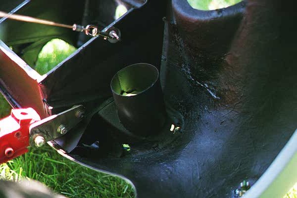

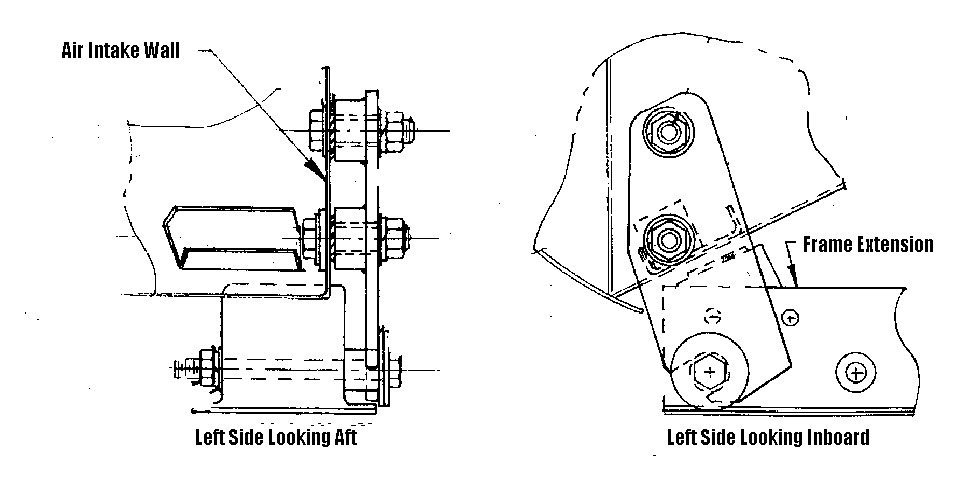

Here are a couple pictures:
Some one used the rubber blocks that mount a spridget sway bar as a hinge point.
That is they just use the blocks and bracket mounted to the bonnet.
Such a mount would eliminate any rattleing.
Had a BE that had homemade brackets bolted to the bumper mount holes on the frame and a rod running thru the normal BE front end latch rod holes. Worked very well.
