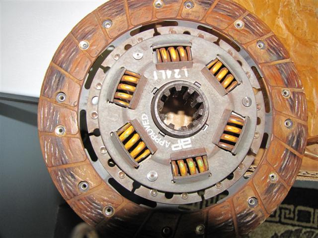

I know we all like pics,so I dug out the last B+B disc and presure plate that I removed in about Feb of 2002.This is clutch #5 from 1990-2002 with a little over 30,000 miles driven collectively.This last unit was correctly located as I had learned about the dowel locations by this time. This unit was removed because it chattered so bad on engagement in first and reverse,especially when hot that it was almost impossible to drive without popping the clutch at take-off.Btw I am not trying to convince anybody as to what clutch to buy,just relating my experiances.
Pic #1 B+B AP Approved Disc made in England. note wear pattern from outer edge to about centre of rivets,but no further,I have no answer for that one. Springs at 1-3-5 o'clock position are loose in there holders and can be freely turned. Others are tight.

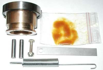

for some reason I could only post one pic at a time anyway this is the kit and part number that is currently installed and has about 50,000 miles on it.

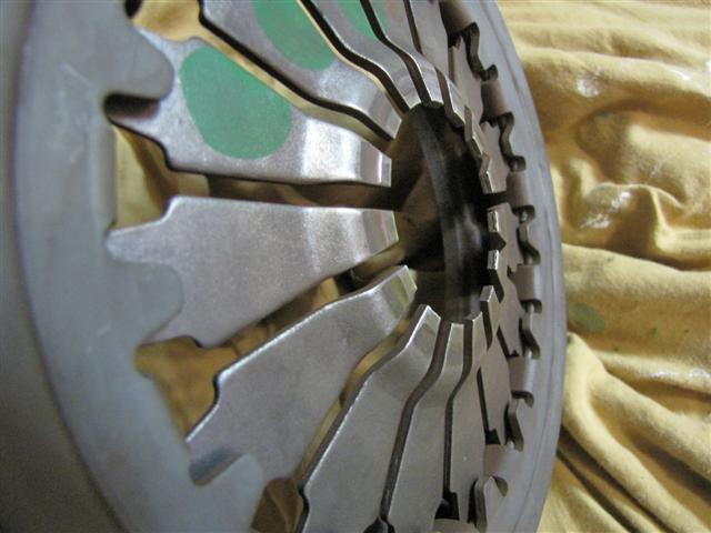

somethings wrong with my silver membership? used to be able to add multiple pics......ok here's a shot of the B+B pressure plate showing finger wear.This I believe is the cranked finger style that Randall reffered to. This plate has about 8000 miles on it as did the disc.
The finger wear is not the fault of the pressure plate, but rather the throw-out bearing and/or missing spring from the clutch slave cylinder. The original bearing is a special free-turning design that should always spin with the pressure plate, even when the clutch is released. The spring inside the slave cylinder should supply enough force to keep it spinning.
But practically all of the 'uprated' bearings (plus some defective replacement bearings that were on the market a few years back) require more force to turn, and so may slip against the pressure plate fingers when the clutch is released. In some cases, this produces a hideous noise, but others are totally silent.
Joachim Gunst actually supplies an extra spring with his release bearing kit to hook to the clutch lever and provide more force. But apparently there are some kits sold under his name (without his permission) that do not include the spring.

your right Randall,I turfed the spring from the slave many, years ago and went with an adjustable rod and a pull back spring.I believe I did that after several T/O bearing failures. However the wear you see is miniscule,not as bad as it looks in the pic. I'll try and mic it just for interest sake.It was the disc that went haywire.The earlier plates showed about ten times the wear in less mileage due to the oscillation of the T/O bearing.

The spring on the Gunst makes no difference at all with the B&B kit that most of the suppliers sell today. When I bought mine, the TRF catalog and web site said that the Gunst would work with the B&B or the Sachs.
Look at the pictures on my link below and tell me how well three (yes 3) of them worked. Yes, I had dowels in and my original clutch lasted 54,000 miles, so we know how to drive the car. And my wife learned to drive a standard shift on the original clutch. The only reason that it was replaced is because I had an overdrive unit installed by Quantum, so it was done right at his shop.
Clutch Installation
Now, will it work with another brand of pressure plate? Some here have used it and it is fine, so I guess it does. What torqued me off at Gunst (and I still have his emails) is that he blamed TRF and they blamed him, so I got nothing but one replacement bearing out of them and no labor reimbursement whatsoever.
