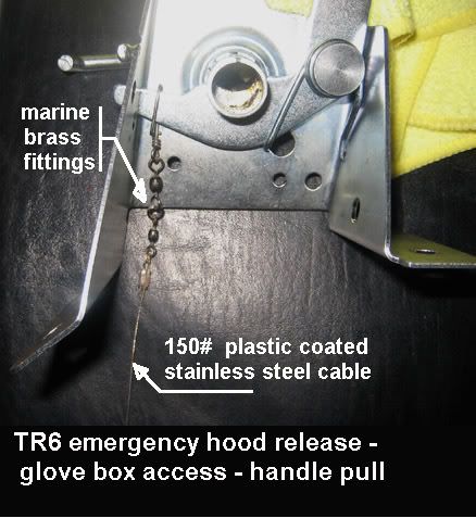

You should consider making or buying an emergency release. They mount on the right side of the car with the cable or rod directly under the hood catch. It is so much easier to use that I don't use the original release.
You will find instructions here; https://mywebpages.comcast.net/rhodes/bonnet_release.pdf
Thanks guys
The PO had installed a cable release on the right side and wasn't using the original left side. I have the taken the left side all apart and checked it and lube it and it works. I was going to add the extra right side as a back up.
That lever set up looks like a slick set up. I think I'll make one.

I installed a new latch mechanism and cables. The new
release cable works maybe one in 20 tries. My Macy
emergency functions maybe 1 in 5 tries because the
aftermarket latch is somewhat different from the OEM.
I installed a third release mechanism as final fall back.
The new release cable works maybe one in 20 tries. My Macy emergency functions maybe 1 in 5 tries because the aftermarket latch is somewhat different from the OEM.
