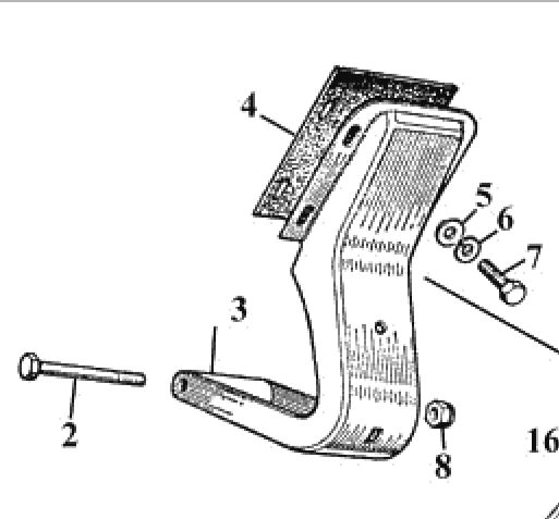

I was wondering why my bonnet came so close to interfering with the body at the rear when closing. I didn't know there was supposed to be a spacer gasket where the hinge attaches to the bonnet. Can anyone tell me what this spacer gasket is made of and how thick it is? #4 in the diagram. Thanks.

Mine does the same thing. When I tried adjusting the bonnet I found what could be the remains of that gasket. No idea what it was originally made from but mine was very thin, maybe paper or the same stuff as the pedal box seal but it crumbled apart when I took some out. What I found in mine wouldn’t act much as a spacer.

I recall the material to be similar to black roofing paper installed on new roofs of homes.
I purchased some gasket material of similar thickness, a little thinner, from NAPA and traced and cut gaskets for my hinges. X-Acto knife was used to cut out the mounting holes.
Original material was virtually identical to 30# roofing paper.(an asphalt impregnated paper) It is .060"thick.

Desert Rat, I bet you could measure the width of your hinges at the point where they would probably bend, around the number 8 in my diagram. That's a whole lot easier than removing unless your car is apart. If it does have a bend might be able to fix with by squeezing with a C clamp without even removing the hinge at all. My car is in pieces and even then these hinges proved very tricky to install, needed a helper to hold the bonnet up and much jiggling to get the interior bolt in.
