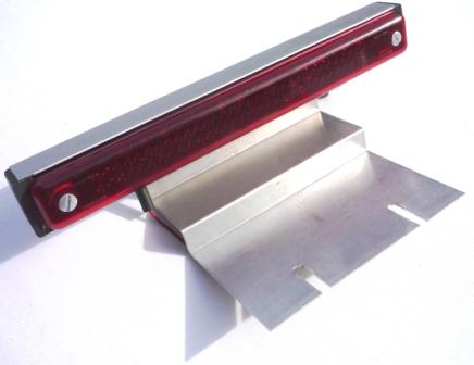

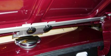

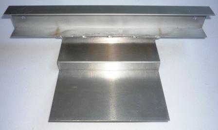

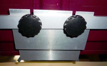

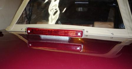

Here's what I designed and built.... It does not permanently attach to the car so it goes on and off in a few seconds.
It flashes three times rapidly, then goes to steady red.
The led by the way came off of a police motorcycle that I purchased off ebay.
