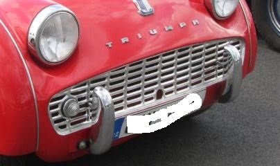

Hi all,
I am considering removing the front bumper blade and fitting only overriders (some rear ones) as shown in the attached photo, picked up from the internet.
Can somebody propose some kind of fixture that can use the existing body holes and fixing points in the TR3A?
Thanks for your comments.
Jesus
It looks like they used the top brace as usual. Then they fashioned a little stub bracket that goes sideways (inboard) from the stock lower mount to the bottom of the overider. So all you would have to do is fashion the small lower bracket.
