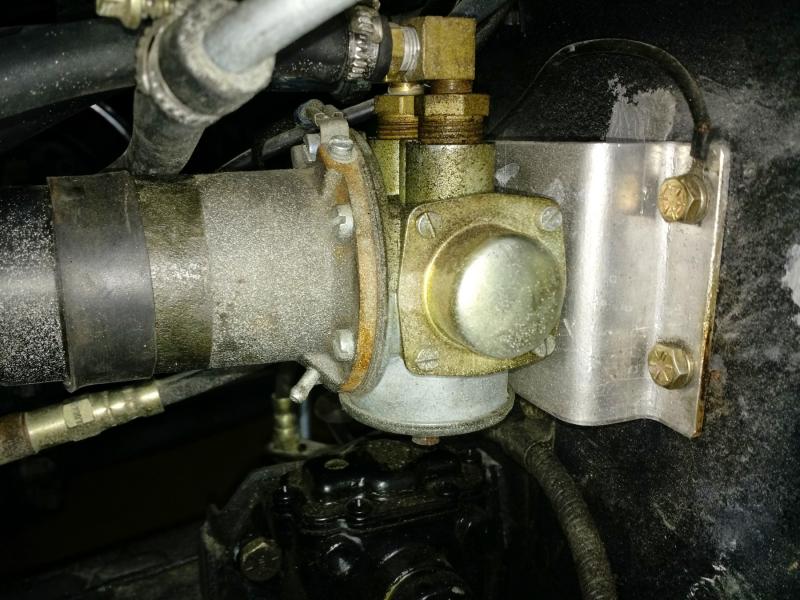

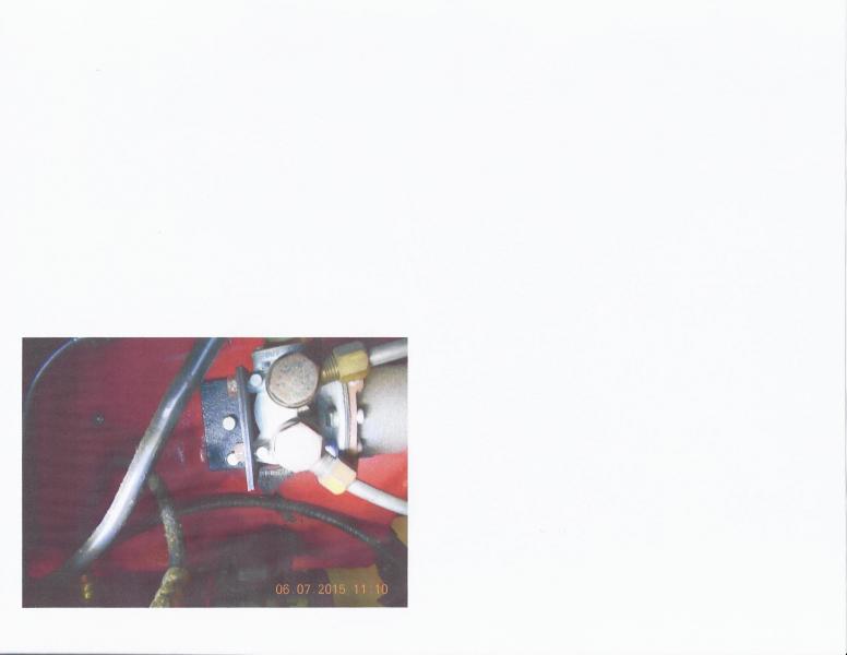

I would like to purchase a spare fuel pump for my PhI BJ8. I have the original fuel pump that I had when I purchased the car in 1997. I have attached two pics below. Is this the new SU square bodied fuel pump? Is the mounting plate part of the pump.

My phase 1 is 25508. It has the square SU pump. I cannot tell from the picture if yours looks like mine. Moss list square pump to 28224. Rebuild you pump. Much cheaper. and easy.
After studying my picture it looks like I have the Part #377-260 mounting bracket and the Part#377-161 SU fuel pump for BJ8's from 28225. Is there a size difference between pump #377-042 and pump # 377-161?

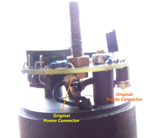

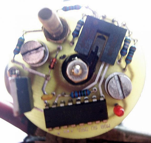

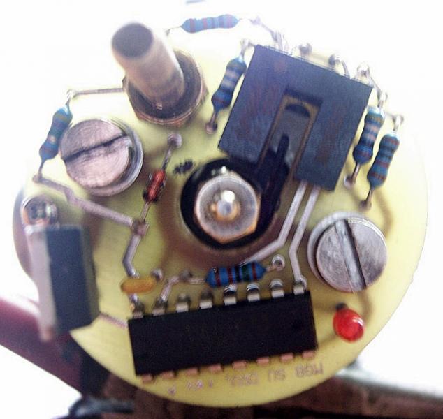

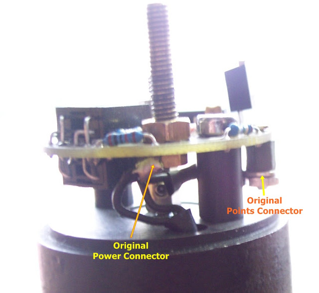

By the way, before I learned about the TSV (at less then 45 cents), I joined 2 other guys out of Origen to design a optical trigger for the pump with no touching parts. Although it was created to have no trigger ware and last for ever, it had no tick and I like the tick. When learning about the TSV, it made no sense to continue and now carry it as my spare.
PCB%u0025252520Pump%u0025252520Top%u0025252520View.jpg PCB%u0025252520Pump%u0025252520Side%u0025252520View.JPG
Original points pump upgrade for $0.45 and last forever, why would you change?
Ray (64BJ8P1)
That is a DIY home project too.
Sure, but I've tried them all: points, power transistor and TVS diode (Dave wrote the schematic for the power transistor mod, but learned that, ironically perhaps, while the transistor mod limited current and metal transfer/pitting of the points there wasn't enough current to clean the points). Didn't have much luck with the TVS diode--ordered them from England--and, now, it appears replacement points are crap like some other electronic components.

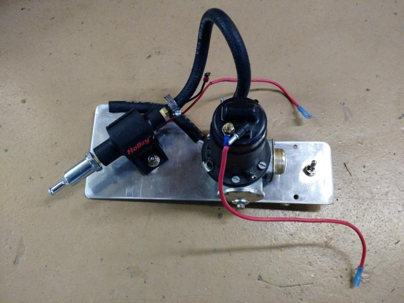

My BJ8P1 has the old style mount where the pump sits longitudinal rather than horizontal. I don't know why. This did present an opportunity to mount a backup pump. I figured if I was going to carry a spare pump, I might as well go ahead and mount it.
I made an aluminum bracket with a backup pump that bolts to my original mount with no additional holes. I put a switch on the bracket that I can flip by reaching through the wheel well in the case of a primary (SU) pump failure. Pumps are serial in this order: fuel tank, fuel filter, new pump, old (SU) pump, fuel line, carburetor. No problem pulling fuel through the new pump and that ensures that it is always primed so you can do a hot switchover.
New pump is Holly HLY-12-426. Basically a Facet style pump in a different form factor. Mounted with rubber grommets at 45 degrees as per directions. It's probably quieter than the SU pump but it runs all the time.
https://www.summitracing.com/parts/hly-12-426/overview/
Works like a champ on either pump.
