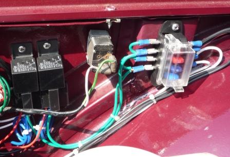

I also installed my own headlight relays on my TR6. I used two relays... one for high beam and one for low all with separate fuses. Total cost for two relays, fuse holder and fuses, plus two spare relays was about $27. I find my lights are brighter now that the relays have been installed.
