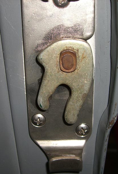

Your situation may be a worn out striker? Photo of my not-new striker shown below. I just have too much time on my hands, so I use metal polish to make it look...like new. (see the worn off left corner)

I was down working on my car today. I also have two clicks with additional play after the second click. The spring has a good amount of tension on it though. There is no play between the catch fork and the shaft it is attached to. Here is a video of the latch in action. Below that is a photo of the latch in it's second locked position. I'll be down there again tomorrow and Wednesday to if you have any follow-up questions.

My left and right door latch has some play after the second click, just as your video shows. I believe it should have some play after the second click.
I had the same situation with my doors not staying in place once the second click was heard.
I spent a bit of time playing with striker position. Gradually I got closer and closer to it not having any play when shut. It can be done, but it takes a lot of trial and error. Not only placement, but using shims too.
The problem may be with a worn out striker.
That's just awesome, Greg! I'm beginning to believe that a bit of wear-caused play on the fork is not a big deal.
