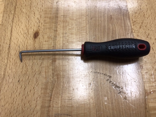

It’s 3/4” nut behind the dash. I took a cheap, long 3/4” socket and cut a 1/4” slot in the side a coupe of days ago. Will remove the tach and see if it works today....
I tried using the 3/4” deep socket with a slot cut in the side. Unfortunately the clearance between the nut and the surrounding wood is so little that I could not get the socket to engage the nut even with the end of the socket ground down to a minimal diameter.
However, I was able to use that minimal clearance to advantage with the 90 degree pick in the attached photo. With the tachometer removed, I placed the pick between the nut and the surrounding wood and pulled firmly down, rotating the nut. Will see how long this stays in place. If not successful will undo the nut and add thread locker and repeat.
