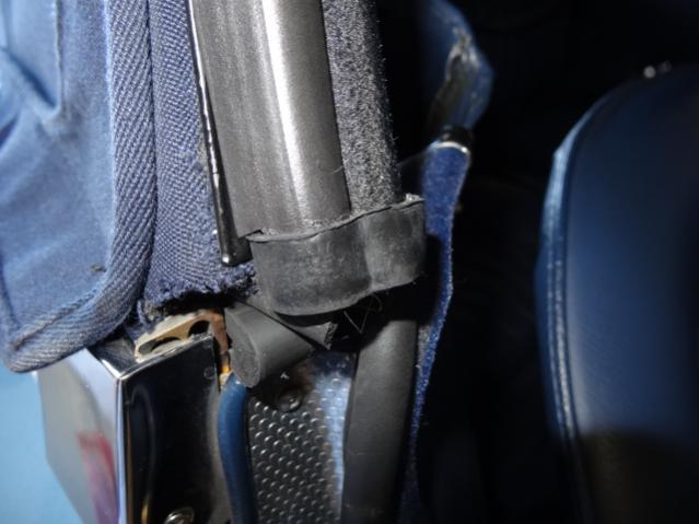

Hi CanberraBJ8,
I looked at all you photos. Nice job with the Dynamate.
Noticed you have a large gap where the rubber over the top of the side window meet the rubber along the back of the side window. Water will come in there when you wash the car.
The wrinkes on the side are from pulling the material down in that area and not having enough pull going towards the rear and the front (I'd try more pulling towards the rear, and continuing to pull the material down as you go towards the center of the rear window.)
It's a lot of trial and error finding the right amount of tension in certain areas to pull everything evenly. It can be done, if you have the patience.

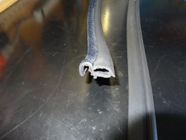

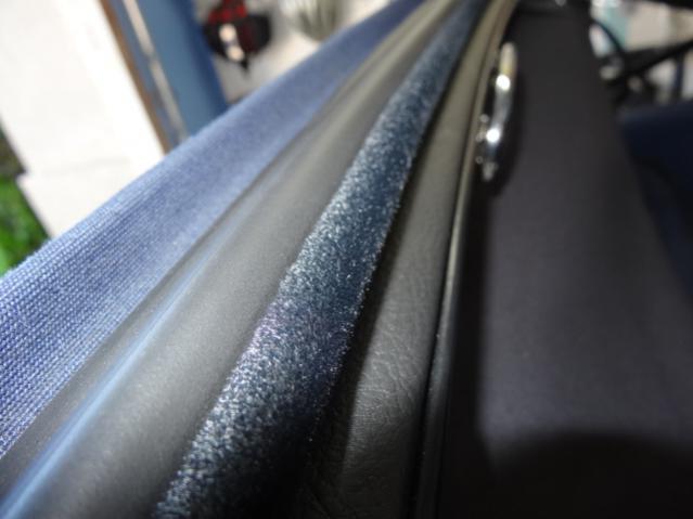

Hi guys
Just a little query about the Bristleflex seals. I've been talking with the guys at The Healey Surgeons about a recent order and they say that the seal that goes around the windows is not fuzzy like the Bristleflex door seals. However photos that AUSMHLY sent me show what looks like Bristleflex but with a different rubber bulb from the door seal. Healey Surgeons described the window/top seal as a webbed material not the fuzzy stuff like bristelflex.
Can anyone shed light on this?
This is correct :encouragement:

Originally it was webbed gray fabric. I remember going to the Dealer to buy it. I wish I had known then that I'd still have my Healey because I would have bought all they had!

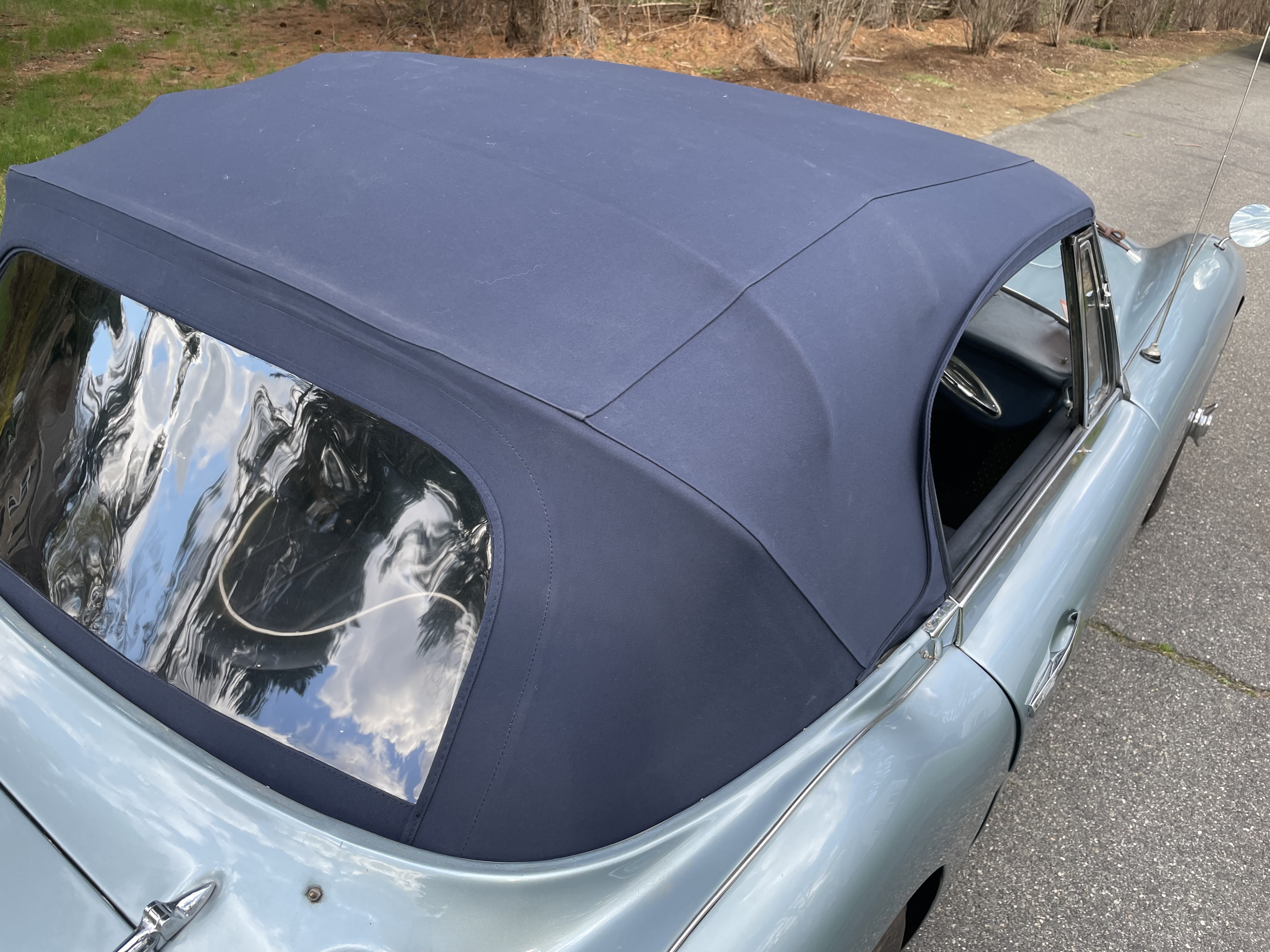

I wanted to thank Roger for all his convertible top posts. After years of dealing with the ill-fitting original top on my BJ7 I bit the bullet and replaced it with a new Stayfast from Robbins. I knew I didn't have the skill and patience that Roger did in replacing his top so I farmed it out to a pro. Came out great, and I took Roger's advice on protecting it with Ragg Top. Sometimes posters help us by showing how we can do things ourselves, other times they're helpful by showing what we best leave to others.
