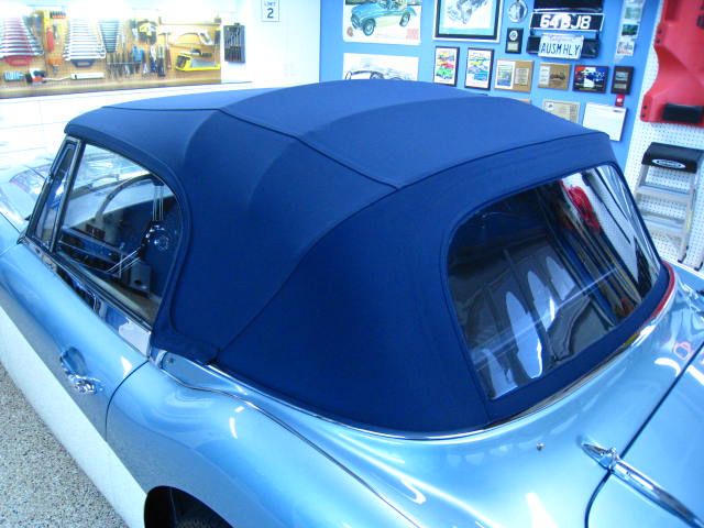

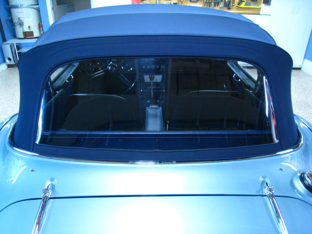

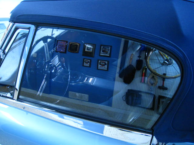

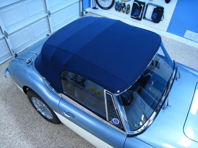

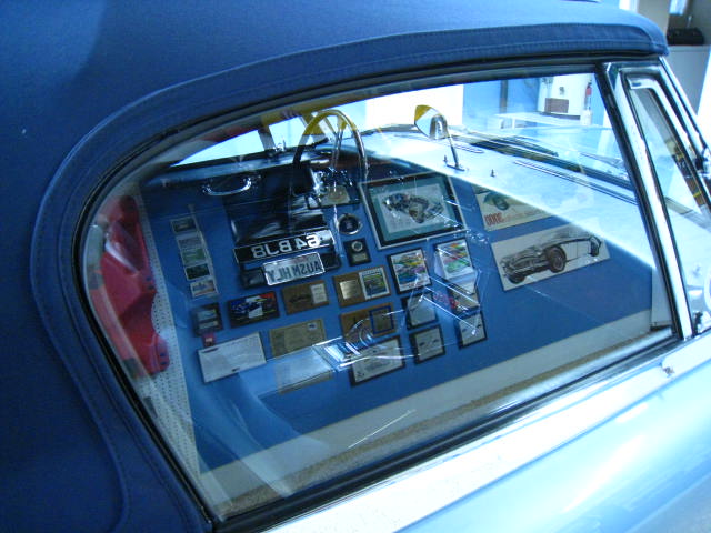

Sooner or later, we all need to replace out convertible top material.
In order to get the best fit of the top material, one needs to make sure the convertible frame is in good working condition, that it raises and lowers with out binding, that it lowers into the rear well and that it clamps onto the windscreen securely. Then there's the how well does it fit question when in the up postition. How's the seal around the side windows and the windscreen.
I spent quite a bit of time figuring out how our convertible top frame works on our BJ7/BJ8 cars. I was in need of a new top, and choose to go with a fabric top, but needed to address my top frame fit issues first. If the top frame does not line up with everything, when in the down and up postitions, then it's not ready to install the material.
I've heard that the Healey top frames are a bit more complex than some of the other convertible frames, so I knew I was in for an adventure. I am thankful to all those here who helped me thru this project. It took me a while to back engineer how it works and figure out what needed to be addressed to correct the problems my top was challenging me to fix.
So for those who are in need of replacing their top, or thinking about doing it, I've searched the archives here on the BCF for you, and will provide the links below. Maybe you'll find some advise or answers that may help you out.
I installed a Robbins Sunfast top on my BJ8. I'm pleased with the fit and finish, and that when driving at speed, it's much quieter than the last top I had, because I addressed the convertible frame issues. Wind noise is at a minimum now and it's acually water tight. Really.
Cheers,
Roger

Re: BJ7/BJ8 Convertible top Q&A
Rick,
Sorry, my intentions were not to scare anyone from trying to do the job on their own, rather to offer help in the form of what others have contributed also.
I've gotten a lot of PM's asking for my help, being I spent a lot of time learning about it. So I thought I'd start a post with links that may help others.
How's that saying go...no good deed goes unpunished. :angel:
Cheers,
Roger

That is the best fit I have ever seen. I can't even see where the two pieces that make up the window frames butt up against each other. Please come to my house immediately and correct my top.
By the way, how easy is it to raise and lower your top?
