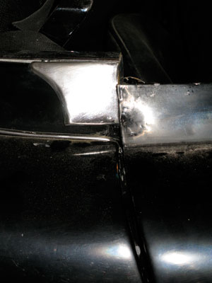

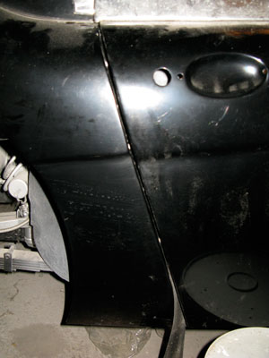

more photos:
In the bottom one the matching body line is slightly lower on the door but, if I added shims to bring it up the wing window frame, which already is too tight to fit, wouldn't fit at all (see vent photo above post)

It looks like there may be something a bit amiss with that rear shroud finisher. The bottom should be right on top of the fender bead, yours looks to be about a 1/2 inch above. Either that or the finisher itself is the wrong dimension. Was the rear shroud ever off the car? If so, was the front pushed down as far as it could go when it was reinstalled? The door does not look to be that far off at the swage line.
Re: BJ-7 Frame Reinforcement- Would appreciate adv
I measured the top of my door yesterday and also got 30½”. I agree with Steve that your shroud is too high where it meets the door (top of shroud to top of fender distance is too great). I’m not sure what you mean by sill backing? It is possible that when you replaced the sills, the rear inner fender may have shifted on you and was welded back in a different spot.

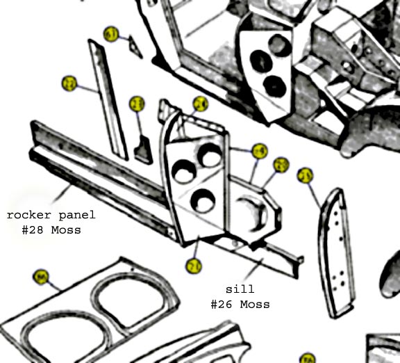

OK, I think what you're calling the sill is the rocker panel. The sill back is the sill. See the Moss ill. if I got it right. This is probably the most frustration part of a restoration. I've been and still am to a certain degree, right where you are. So I know how you feel.

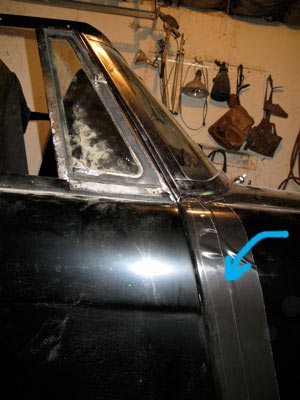

One thing that comes to mind as a possibility. When the sill was removed, the lower structural support for the hinge pillar (which is welded to the outer side panel) would be gone. The pedal box brace would hold it in position somewhat, but there could have been some sag to the hinge pillar that wasn’t addressed when welding the sill back in. An eighth of an inch sag at the pillar would equate to a much larger degree of off-ed-ness at the rear door-to-shut pillar. An additional thing to check is how the aluminum finisher fits along the rocker and sill. While it rests on the rocker, how does it fit the sill? I would venture a guess that it will be too short at the back. The double fold that overhangs the sill will not reach over the sill and still be resting on the rocker panel. The arrow in this photo shows the direction that the hinge pillar would have sagged.
