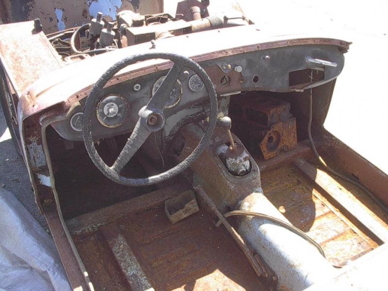

Hello all, I am about to begin getting my BE on the road again after many decades of dormancy. I will need to do a front end rebuild, task looks daunting, and will be installing newer 948 and smoothies.
What are your recommendations as to the best shop manual(s) to use for work on BE's?
I have read that the front end can be shipped to a shop for rebuilding and then reinstalled, anyone with experience with this?
I will have additional questions I am sure once I get into things.
Thanks, all assistance appreciated.
Rut

Paul love to meet you, my car is in a garage in San Carlos where my work will be done, save for painting, I still need to source a painter. Looking forward to getting her back on the road. It's original black plate car, I've had it since high school, rebuilt the 948 then, I think Nixon was President, so long time ago.
apbos
We always want pictures. Mine still has the orignal black plates but I purchased it as a wreck.
