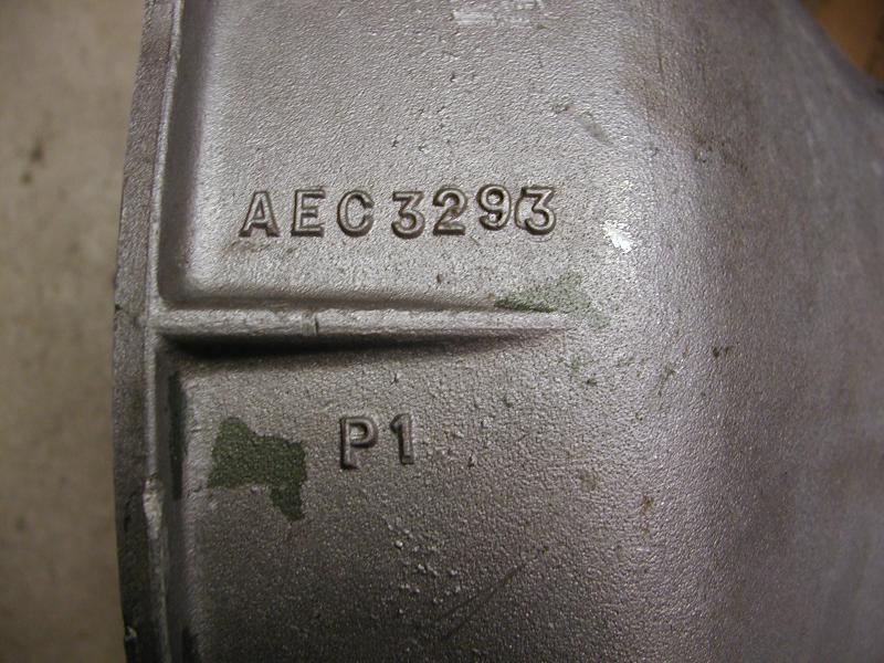

Can anyone tell me what engine bellhousing AEC 3293 was originally paired with? I have a BJ7 engine fitted to a BN6 gearbox with overdrive. Want to make sure the correct bellhousing is fitted.

Trotti,
My BN6 has the same number...

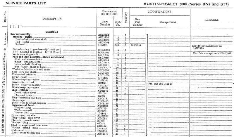

Trotti,
Below is the original parts list for the BN7/BT7 side shift gearboxes, engines: 29D-H101 through 29E-H2245.
