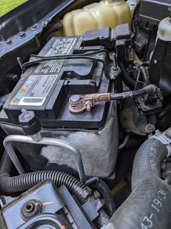

My neighbor just bought a two year old Nissan. We noticed the "blanket" around the battery was rotted away on one side of the battery. Not chewed, but rotted. Touch the blanket and it crumbles where you touch it.
We wondered ... is a battery blanket wrap really needed? What's the purpose? The Nissan replacement part is $65.

It’s a thermal wrap. Protects battery from heat/cold.
Is it needed? I would not replace it.
Thanks Elliot. We might replace it with a generic thermal wrap, when the battery needs replacing. Car is parked outside, and summer sun here in CT will bake the battery.

Thanks guys. If you look at the picture I posted, it looks like the "wrap" is/was rotting away, I assume because something (maybe battery acid, maybe something from the nearby lines and pipes) had leaked - and was maybe even still leaking.
The "wrap" is factory, and I've had that on all the NIssans I've had over the last fifteen years. On a few, the wrap was actually a five sided soft "box", open at the bottom. Top folded over and locked to keep the box closed.
Under the black outer layer, there appears to be a fuzzy fabric, I assume for insulation. Many online references describe the wrap as protecting the battery from engine heat, as (apparently) it's heat that degrades a battery. Cold will reduce CCA, and intense cold may actually freeze and burst the battery. But the wrap apparently isn't there to protect from cold.
