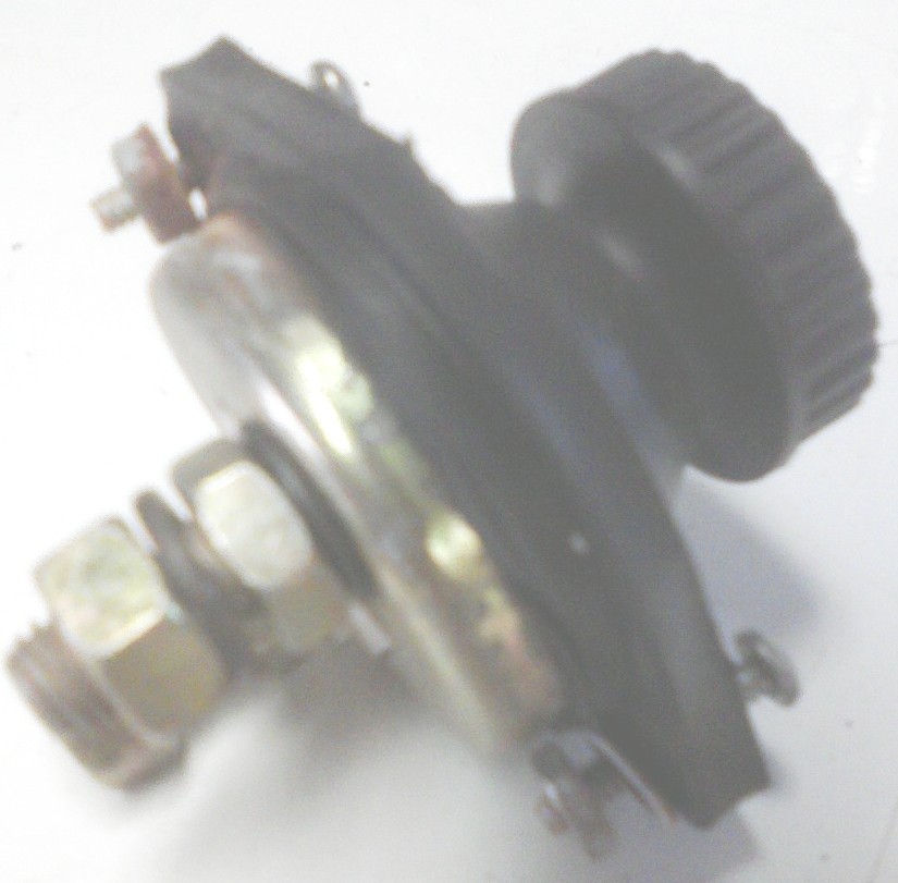

I have a bulkhead mount type that came on my donor car. Can't work on anything I have so is available for the cost of shipping, and a box of cookies.
