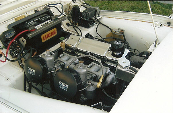

The 'spare' fuel pump I carry is a simple electric that splices into the existing lines and takes power from the white wire side of the coil.
Hooks up in a minute. Fuel pump failures aren't common but over the course of 38 years of driving TR3s I have known a few.

George: In your photo of the electric pump, I see two wires: a black and white one and a white an black one. Which clip goes on the coil" And where does the other clip go (a ground?).
Also, can you tell me where the tube hooks up. It appears to be to the outlet, but I just want to make sure I understand which side of the fuel pump that would be.

Most fuel pumps will have leads labelled + & -. Connect based on how your car is grounded, i.e. if positive ground car then the negative pump lead goes to the coil (other connections are possible but this one shuts the pump off when the ignition is switched off). Any ground will do for the other lead.
<div class="ubbcode-block"><div class="ubbcode-header">Quote:] Also, can you tell me where the tube hooks up...[/QUOTE]
The pump I used has 5/16" fittings on each end. If you look at the photo you'll see that the hose gets reduced to 1/4" using a couple of brass fittings:
To use this pump you disconnect the fuel hose from the short hard line that goes into the stock pump inlet. The 5/16" inlet on the electric pump connects to that hose.
You also disconnect the fuel hose that goes to the front carb. The 1/4" end of the hose from the electric gets connected there. After that you let the fumes clear a bit then make your electrical connections and hopefully have a heartbeat.
All that assumes that: 1) you have a pump like mine 2) you have hard and rubber lines like mine (which I think are 'correct') 3) you made the hose on the electric long enough to reach the front carb.
There are many ways to do this and in any case will have to be adapted to whatever electric pump you get. As Randall notes, you want a low pressure pump.
