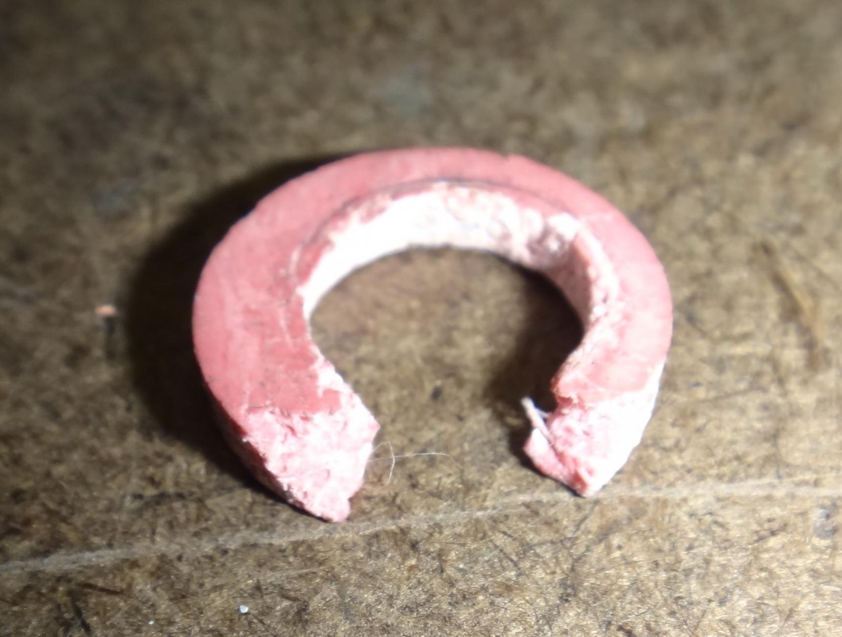

I know the feeling well! Very same thing happened to me when we attempted the first start after the body was back on. I cinched down on the nut a little to much too. The results was the crushed fiber insulator (photo) and the grounded post. There were plenty of observers on hand, so fortunately, the fellow tasked with activating the solenoid switch recognized the problem quick enough so that the contact didn't weld itself closed. Even with it shorted for a few seconds, the cable got hot enough to melt the shrink wrap on the lugs and a bit of the insulation. In addition to a new cable, I followed their unanimous advise to take this as an opportunity to upgrade to a gear reduction starter to replace the original. The new setup works great.

Was the nylon? insulator that passes through the alloy end plate? or the next one which is some sort of plasticized woven material that broke?...
The nylon tube was fine (don't think much can happen to it) it was the washer pictured by Rick.
In retrospect, there is probably no need for that first nut to be more than snug - though it then helps to have a wrench on it when you tighten the nut that holds the cable.
Yep, first nut, its job is to provide stop for the cable and help hold it tight. Doesn't need any pressure on or against the starter. I learned the hard way years ago. I twisted one off.
