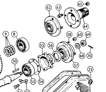

I'm sorting out a few things with my TR3A rear brakes, and was wondering about checking the axle shaft end float. I'm not finding it clear in the manuals that I have if I should tighten down the castellated nut (#69 in the pic below) to spec first and then measure? I assume so, but want to be sure before I crank things down in there.
