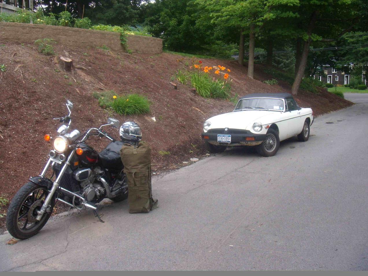

Bcf bike and mg.jpg Holy crap after years of fiddling i have actually put a picture on the internet!!!! This is an old shot as i had little hope of figuring this out so i took no new ones of todays progress. That was taken weeks before i put my car away.
