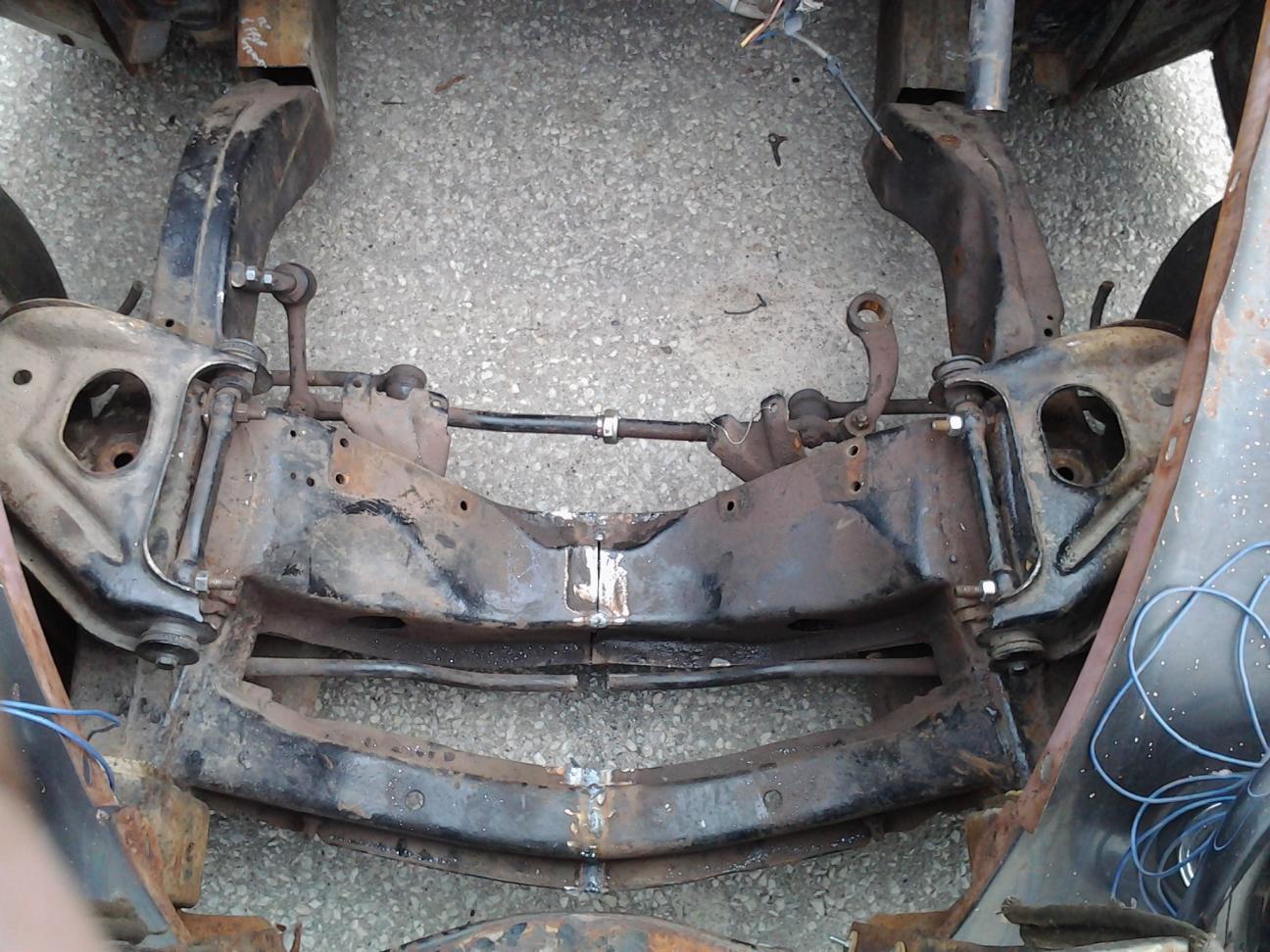

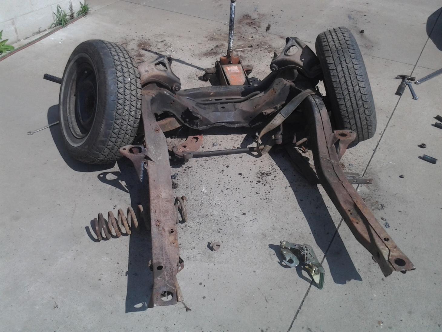

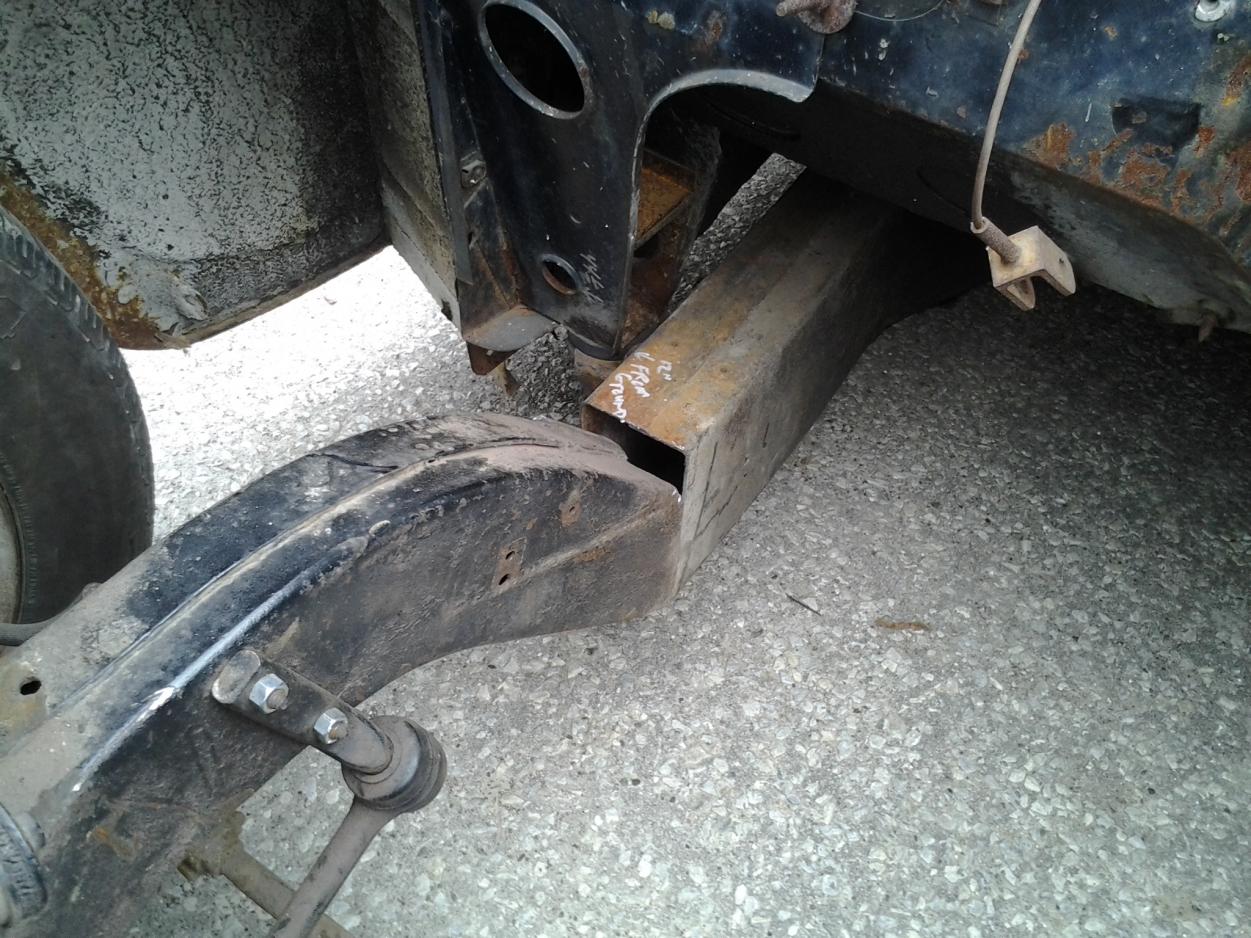

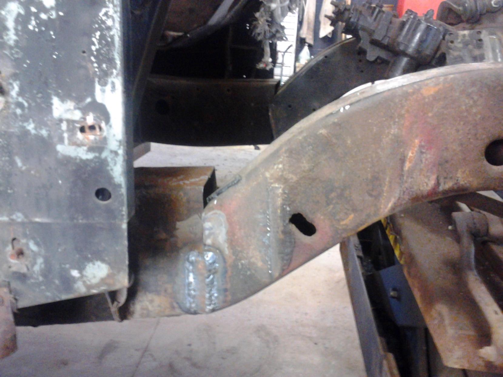

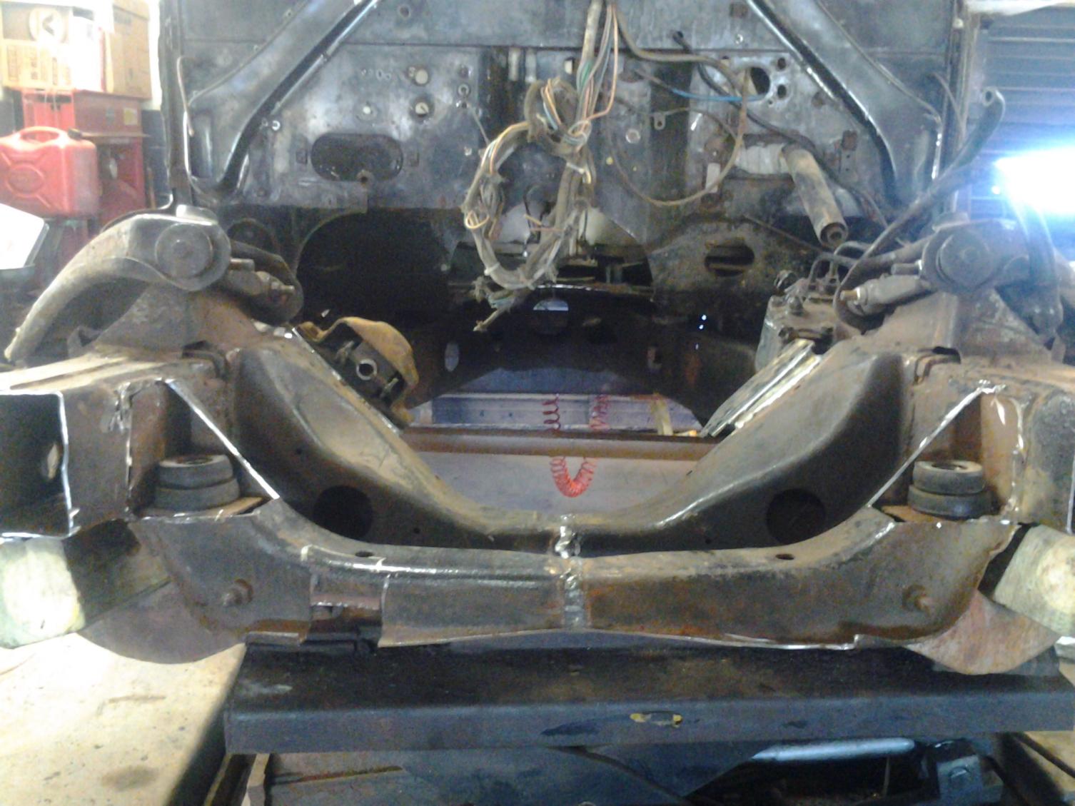

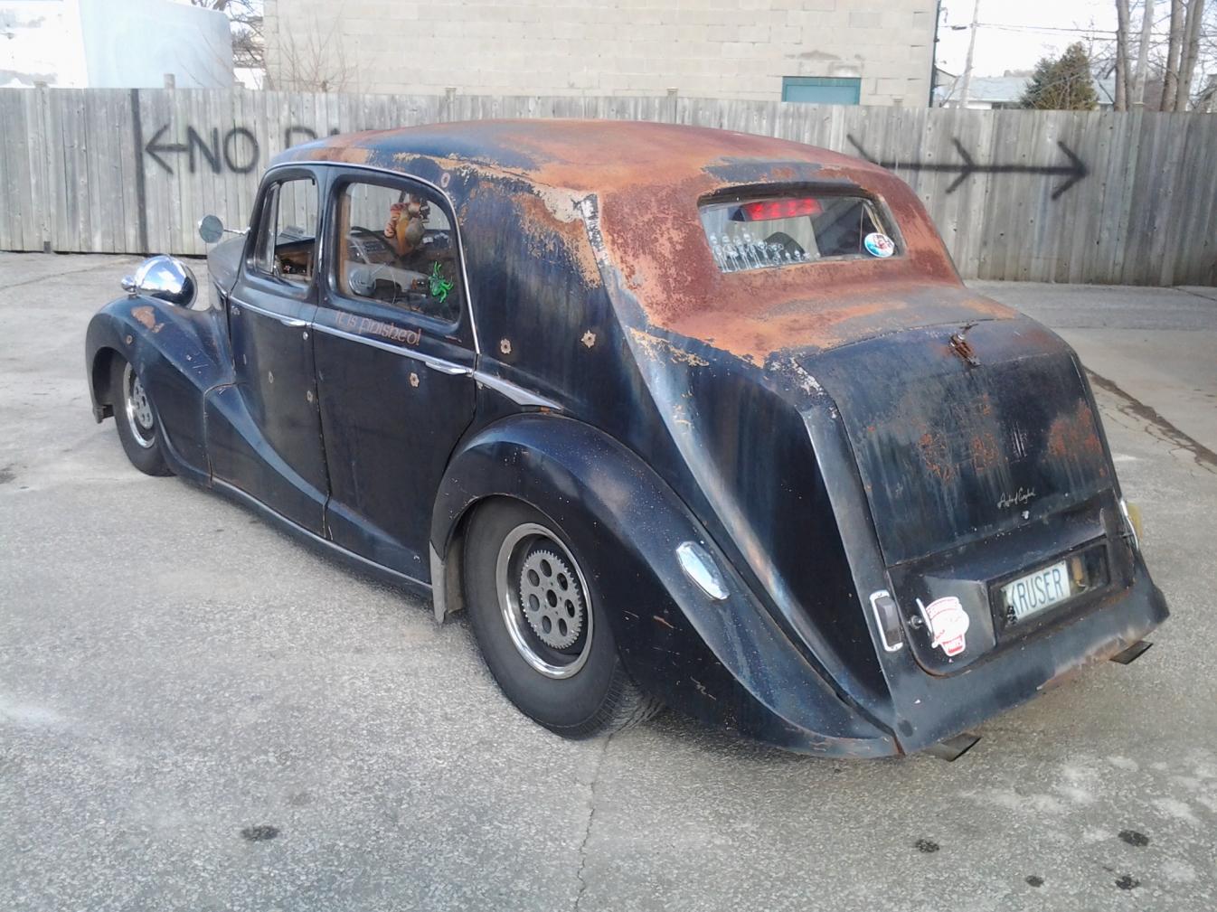

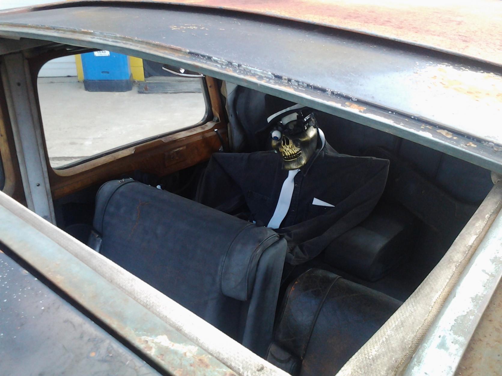

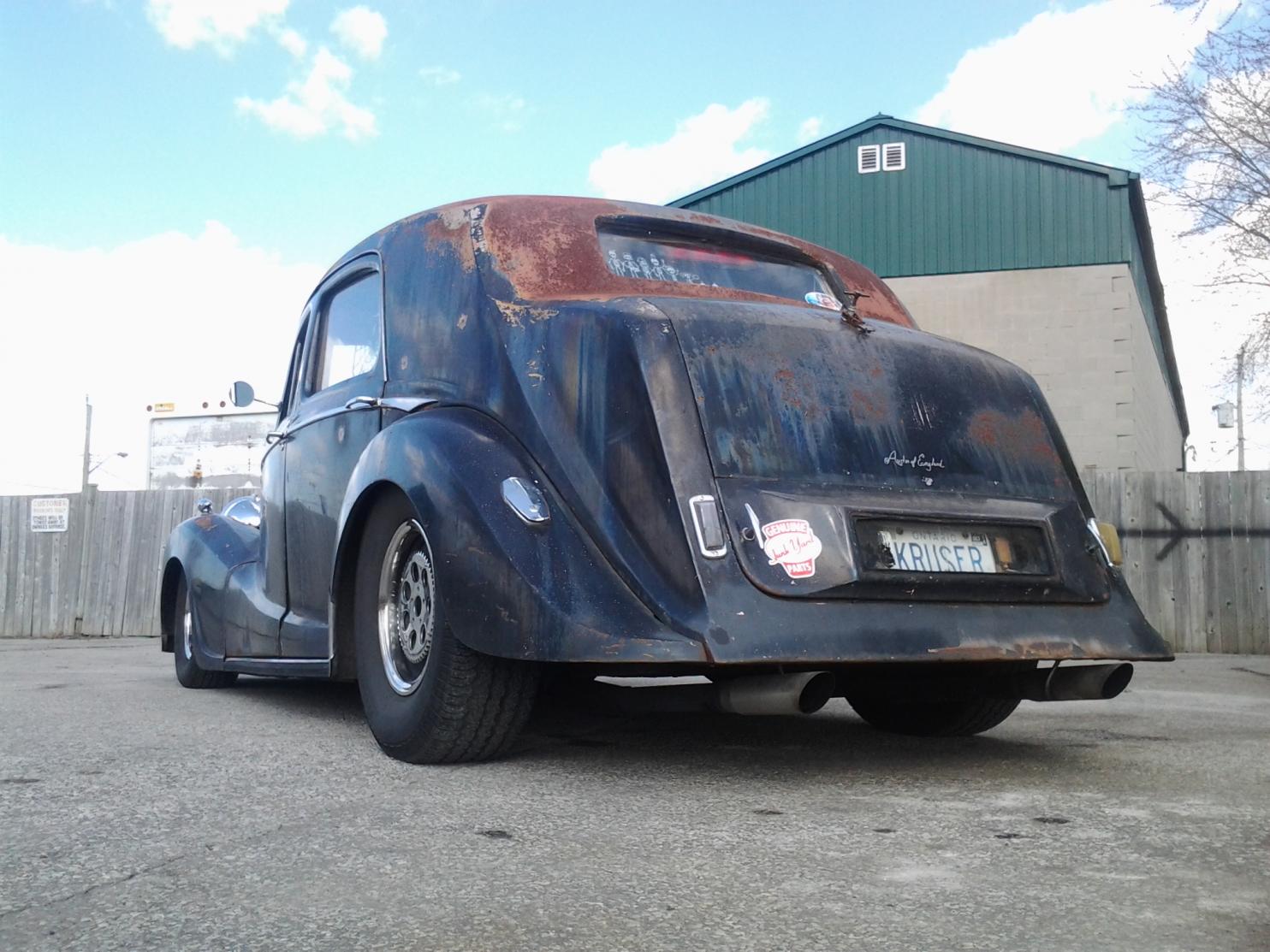

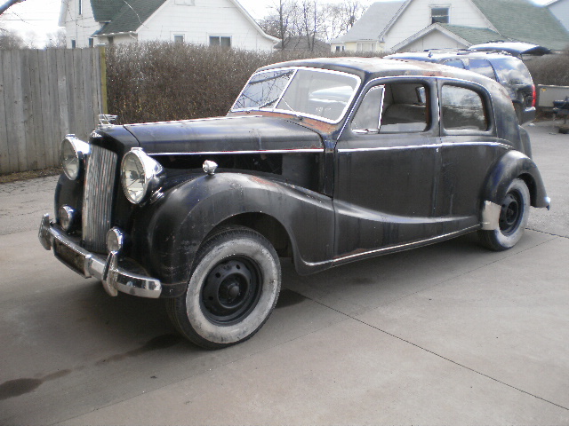

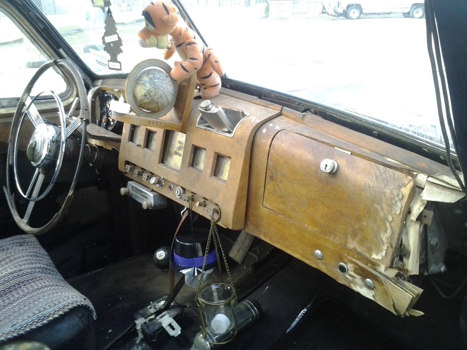

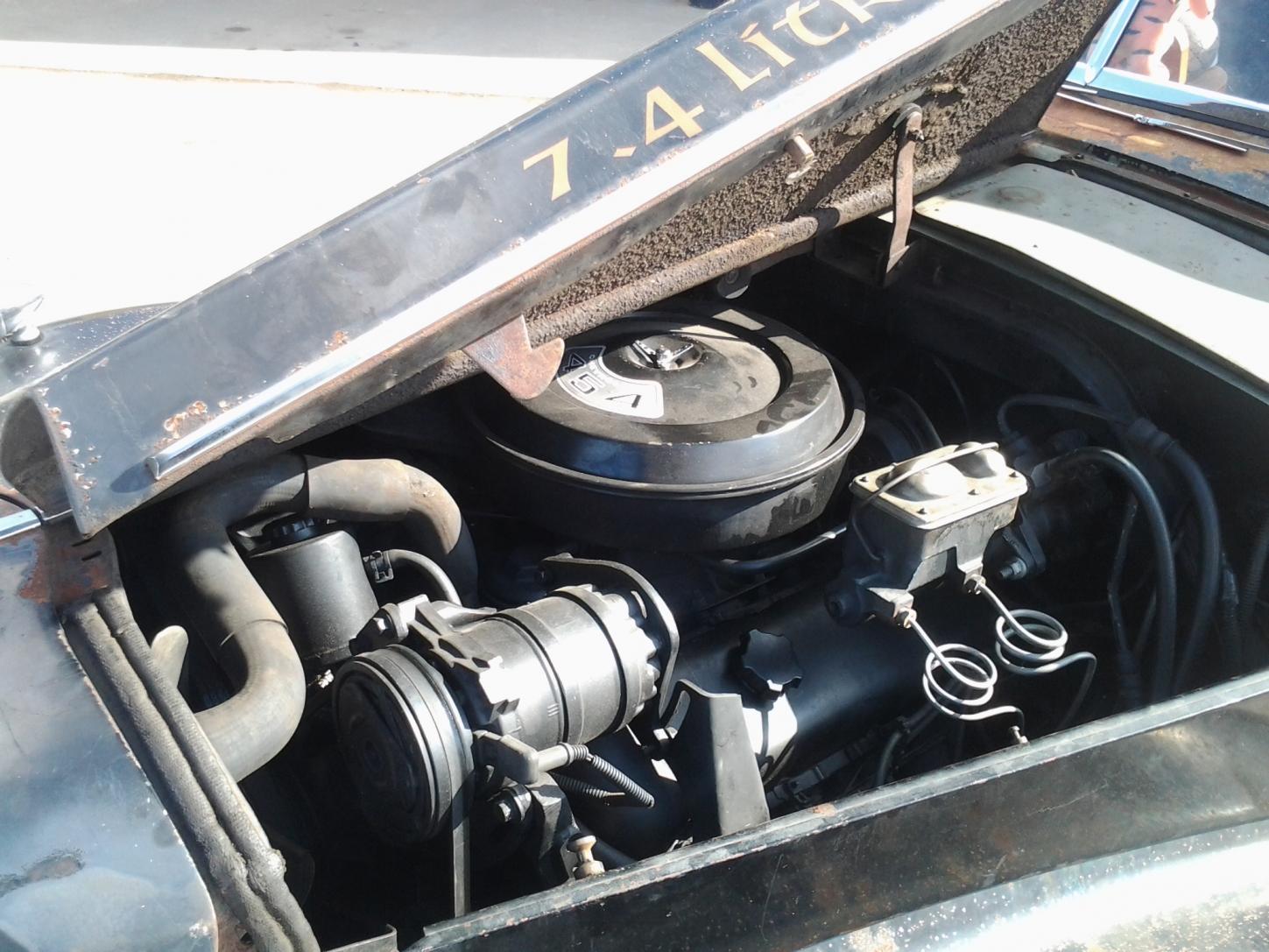

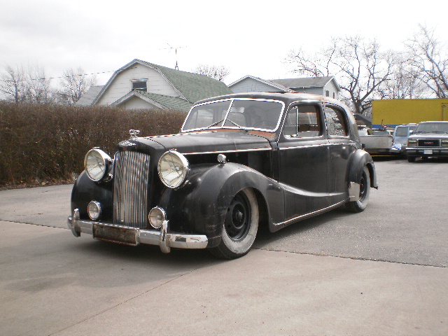

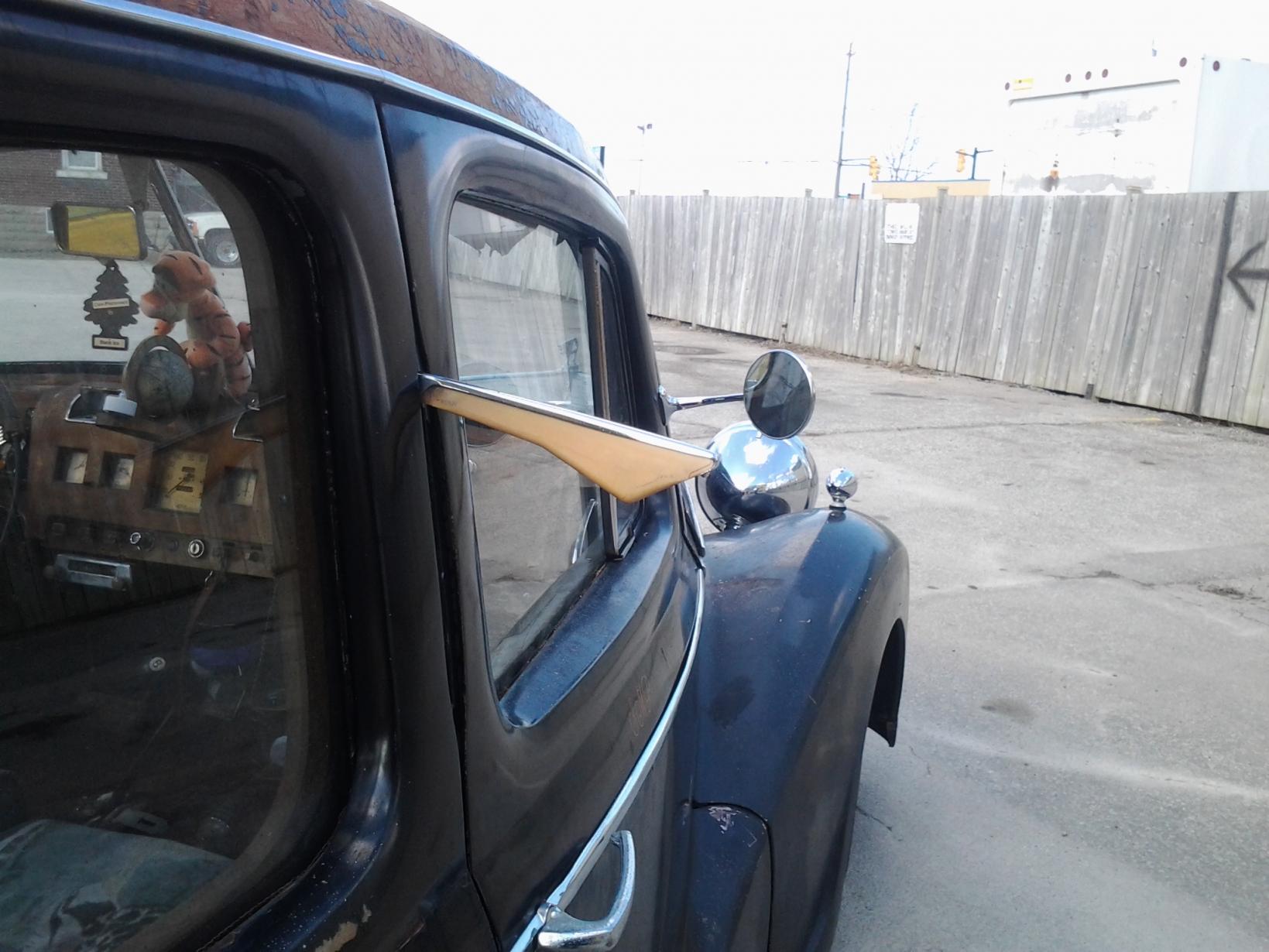

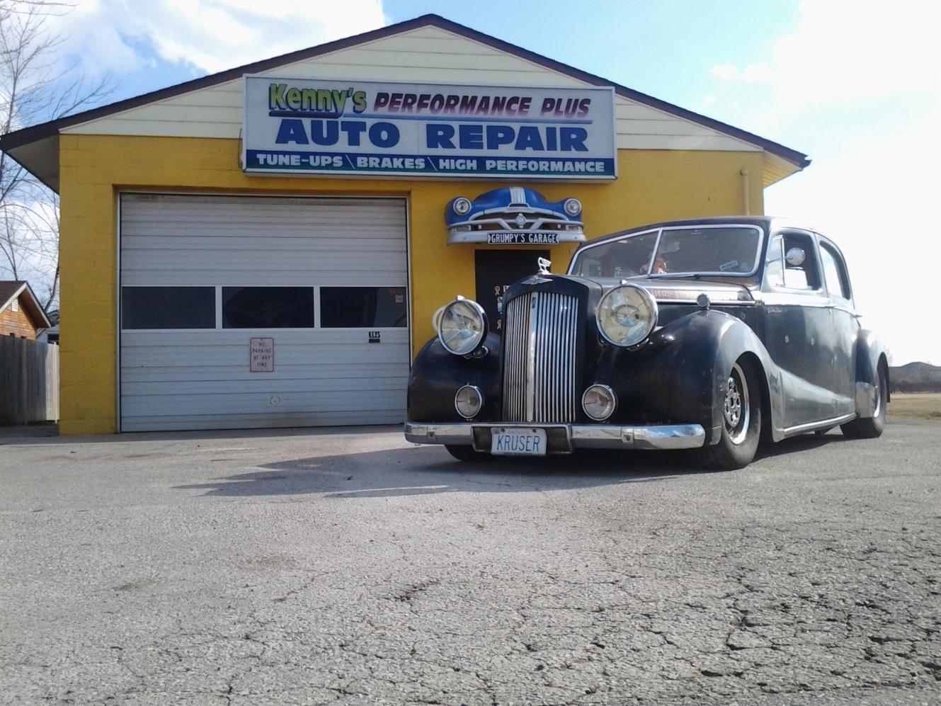

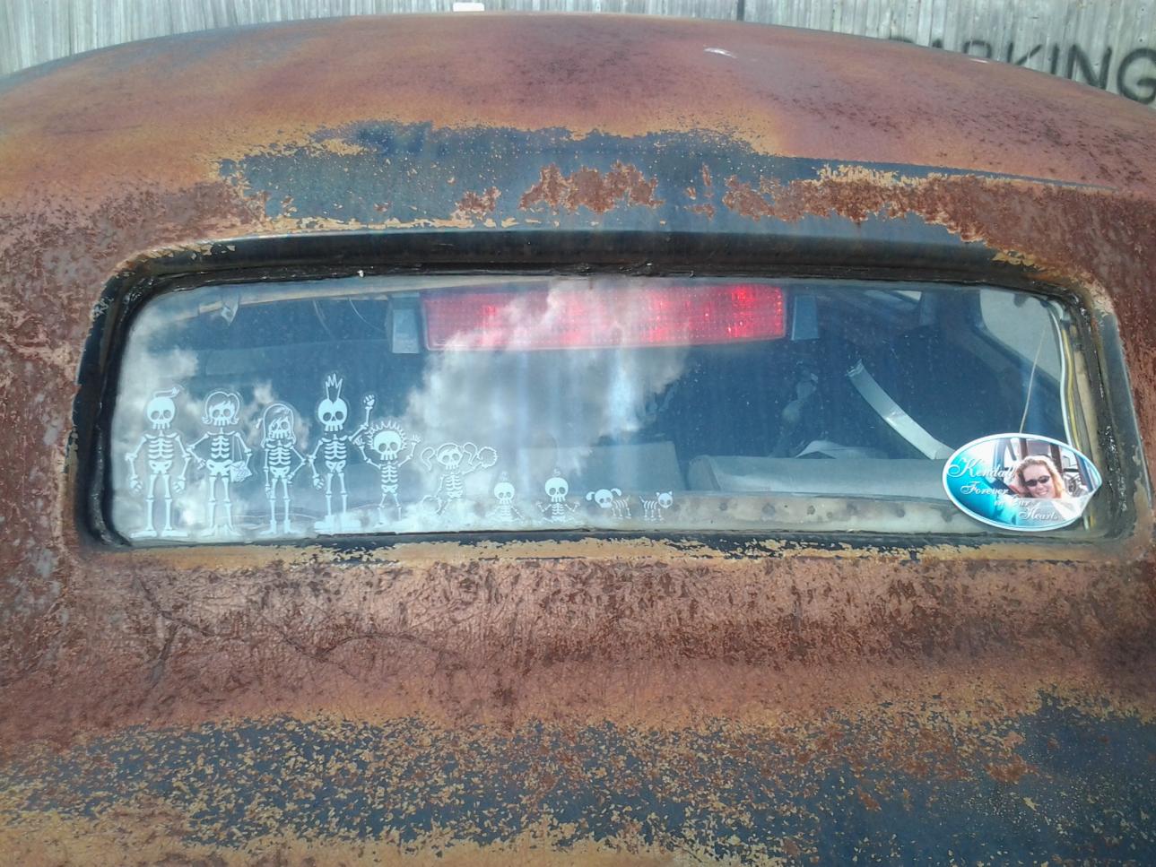

Hello. Neat project, looks familiar. I have been driving my 1947 sheerline for 2 years now. I built it in 6 weeks after sitting 20 years in someone's backyard. It has a fuel injected 1988 454, 4 speed auto, 373 10 bolt on stock lowered rear suspension, 69 Camaro front frame clip narrowed 3 inches to fit with stock uncut coils, PS AC PB disc/ drum, 55 year old black lacquer. Only one hot rodded in North America.(I think) And I drive it over 5000 miles a year. Best thing is it is a Austin still driving!

It is the least expensive and simplest way to upgrade steering and suspension. I have way under 7500 dollars and 200 hours invested. I could probable engineer RHD as well. Mine was LHD from factory. Sold in Hamilton Ontario. I have a receipt for 6 quarts black lacquer from 1955 or so for 18 dollars from the dealer!
