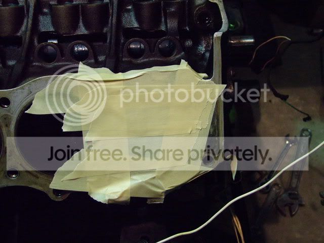

So he it is 3 weeks later and I am working on it again. Removed the ARP studs from the drivers side and reinstalled the factory bolts. Torqued them to 70lbs. and all is good,on that side.
Removed the studs from the previously mentioned Fubared side. Removed the head and the good news is I think there is only 1 bad hole.The drill bit I needed for the repair inserts is 37/64's and when I pulled it out of it's case "Man that's a big bit". I think I will buy a couple of in between sizes to help step it up.
Next step is tricky. Keeping the bit perpendicular to the hole. Wish me luck.

Don, are these Helicoils you are installing? That would mean the studs are 9/16" diameter, so those stripped threads are already at 36/64". My suggestion would be to skip drilling, and just run the tap in, using short strokes and plenty of lube. It will act as a reamer to remove the excess metal, and the hole itself will help guide it.
I've repaired several holes that way (including intake manifold bolts on my Stag) and it's worked great for me. Taking out that tiny bit of metal with a hand-held drill motor is a recipe for disaster IMO, as the bit is bound to grab and twist.
Another option might be a straight flute reamer instead of a drill bit (in a tap holder instead of a drill motor). If you wanted, you could even grind down the edges of the flutes for a bit, to act as a pilot; but then you'd need a second reamer to finish the bottom of the hole.

The bolts are 7/16 for the head. I mic'd the hole out at about .431 and I am using Keen Serts. The tap is a 5/8's 11 The drill is the correct one so I have about .189 or 3/16ths of material to take away. Don't think the tap will do that.
And as you can tell,the motor is still in the car.
Yea that's a bit much.
hmmm. I'd go for the homemade jig, or using multiple drills, and step up in size to the right one. Take just a little out at a time.
