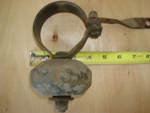

I friend gave me this part and said he thought he knew what it was. After looking I can find nothing to confirm his idea.Can anybody ID this part and what car would it go to. It looks like a great way to add 3.5 pounds to your car. It does have a number on it (V2794S)

It looks like an item that is used on some TR4s to reduce resonance vibration at 3000 RPM in the exhaust pipe. It is mounted towards the rear end of the gearbox and is commonly called a "lump".
:iagree:
Except I think it's P/N 132604 and called a "weight and bush assembly, vibration damper".
4A's as well I think - the side strap makes me think its from a 4A probably for the exhaust but I might be wrong.
:iagree:
Exhaust related for sure.
The 4A non OD transmission (CT72579) in my garage has that damper attached at the very rear. That side strap went forward to a brace that also holds the reversing switch.

It was wrapped on the back of the transmission and whether it worked or not is up for debate. I have even saw them on the back of a overdrive.

Yep had one on the back of the non-overdrive transmission that was in my original TR4A. I'm sure I have it in a box somewhere with the rest of the parts that were left after I converted it to overdrive.

Well my friend was right in his thinking. One of many high tech ideas used by Triumph. I may have to get a TR4 so I can put it to use.

It's on my 4A as well. The strap goes between the damper and the cup that contains the shift lever on the top cover. The through bolt of the cup goes thru the strap, the cup, the top cover and the shift lever.
No association with any back up light switch that I've ever seen. TR4A's never came with back up lights. 250's yes. Don't know if this damper was installed on 250's.
That's curious, since the SPC shows "Fitted from gearbox No CT17815 up to Gearbox No CT35719". Is it possible your car has received a transplant?
And, not to be too picky, but a backup (aka reverse) lamp was listed as an optional accessory for TR2 through TR4A. I don't know how many were actually fitted, but it seems likely there were at least a few. However I agree that there was no strap to the switch, since it was installed like an OD switch through the top cover (except over the reverse rail).

Mine is in that range and indeed had one. When I replaced the original gearbox with an OD I retained that mini-boat anchor. What wuz I thinking? Things are crowded enough (and heavy enough) back there w/o having that thing. Next gearbox R&R I may end up with a new paperweight.
I think they went past that number and definitely into the 4A's. I've seen too many 4A's with them. Perhaps they were not mounted universally, however? Possibly some ad hoc testing and the dampener added as needed?
My originally non OD 4A has a strap from the shifter to the gearbox mount and exhaust bracket but no damper.
Well what was I thinking. That strap does go to the exhaust bracket not the top cover (my bad)There is another strap that goes from the Trans mount to the top cover. Randall, I wonder where the one TR3 thru TR4A with Backup lights fitted originally from the Factory is now, seriously I wonder how many were actually fitted. I know some others have done what I've done and drilled and tapped the top cover and installed a back up light isolator switch. My friends laugh at me but I don't care, it's my car.
