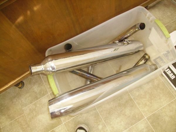

Dumb question: I've got a couple of H-D mufflers (case of beer to the shop that gave them to me for free; an owner had upgraded to more noise...)but they're pretty bulky. I tried lying under the BE a year or so back, and couldn't figure out how to install them, as they were too long to go behind the axle and too bulky to install under the axle.
I'll try to get some pictures this week, and also try to figure out how to attach the photos!

You probly have the dresser muffler. I believe JP is runnin' one'na those.
Thanks,
Doug
That's not what I've got - mine was no problem to fit behind the axle.

Is this one I would want for a Sprite?
No, that's off of a big bike (dresser or FLHT IIRC) You want the Dyna/FX/Softail, maybe a sportster type too.
No, that looks aftermarket or like straight pipes.
