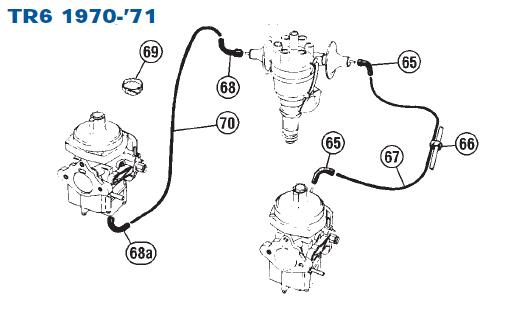

Randall, I agree, as many cars ar ported "upstream" of the throttle valve - the manual Luke posted even shows this. I went out and checked my carb before I posted. Mine is not, but rather the port is located just downstream of my throttle valve. Replacement carb on mine maybe?
John
Quoting John:
"Randall, I agree, as many cars ar ported "upstream" of the throttle valve - the manual Luke posted even shows this. I went out and checked my carb before I posted. Mine is not, but rather the port is located just downstream of my throttle valve. Replacement carb on mine maybe?"
That sounds like the location for a Vacuum Retard's vacuum source.
My thought exactly.
However, I've never heard of an SU H6 with a retard port ... are you looking at an H6, John?

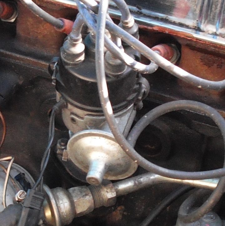

It's an emissions thing. By retarding the spark at idle (usually to 4 degrees AFTER TDC), supposedly the combustion is more complete and fewer unburned hydrocarbons (HC) go out the tail pipe.
But the effect is only needed at idle. So for most cars (TR250 and some 69 TR6 being a notable exception), they cut a special 'retard' port into the carb that supplies vacuum only when the throttle is closed. Then there is a special vacuum module on the distributor that retards the spark when vacuum is applied, instead of advancing it. Usually (tho not always), the retard port will be on the "back" of the capsule.
Some cars even have both advance and retard.

Here's a shot from another thread, showing one of the "backwards" vacuum retard only modules.
