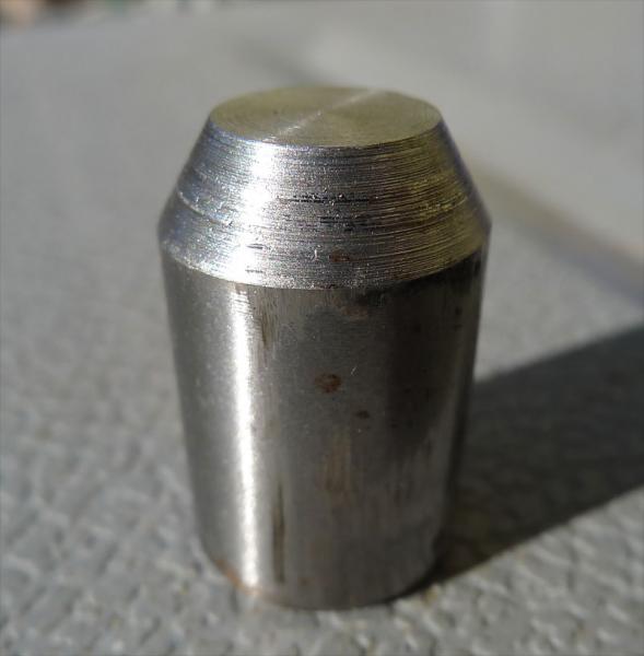

Here's the promised pic of the pressure relief valve.
That pressure relief valve doesn't look like it would hold pressure very well, can you tell what the mating surface looks like? I know there's some leakage past the valve, but that one looks too rough.
Rut
Since I took it somewhere to do it, I didn't have them use a bore scope or anything to look inside the block. It took them an hour to get it in so I didn't want to rock the boat.
Again, this is the old one. I had a complete new assembly with packing that replaced it. It looks like the oil pump end (pic in post #5), but not as severe.
