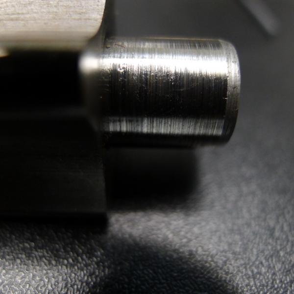

The uprated oil pump was fine but the part that goes into its housing was heavily scored. The rest was perfect. Put in another one just in case.

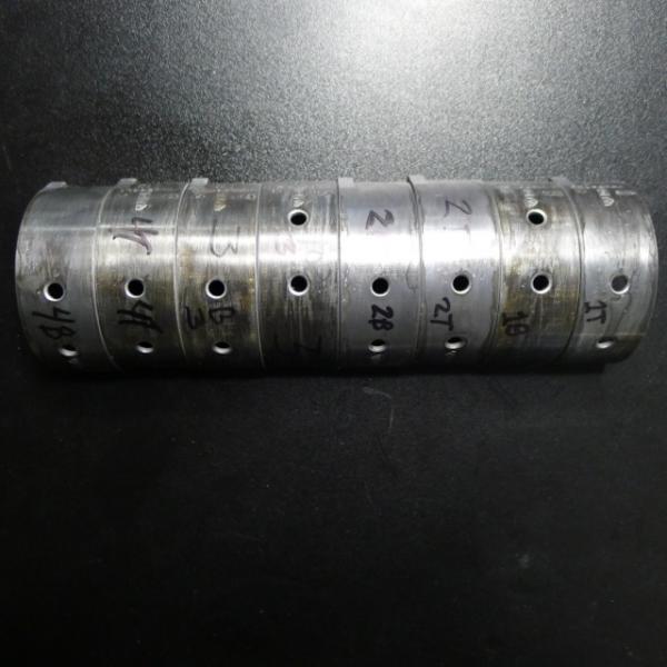

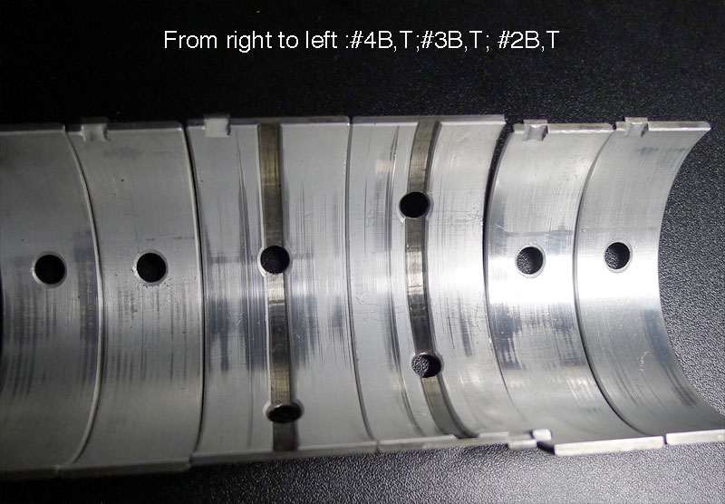

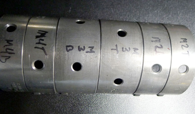

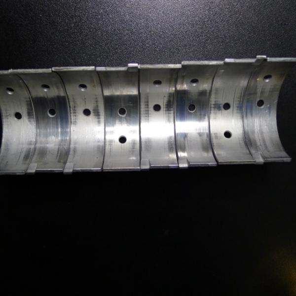

I confess I got depressed at the rods so I stopped measuring. Here are shots of all the bearings. T= top B=bottom. Also is the end of the oil pressure shaft that was replaced.

It looks like either the crank journals are not round or the engine was dry started. You don't have any evidence that the pistons were hitting the cylinder head or gasket? Did you plastigage with the old bearings or new?
The engine was not dry started. I started the engine and everything should have had assembly lube. No evidence the pistons hit the cylinder head. That was a concern. I did not plasti-gauge the old bearings. Those were readings from the new bearing.
Probably should've turned the crankshaft. I hate to be the first to say it but you've probably got metal throughout the oil galleys in the engine now. Either live with the oil pressure or redo the engine.

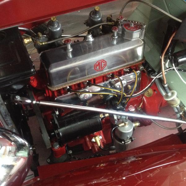

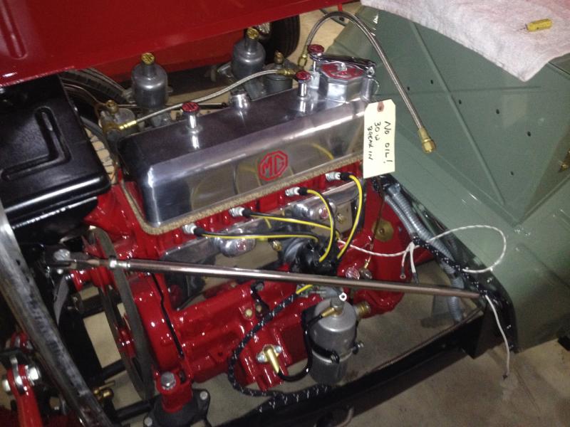

Run it for 500 miles and take an oil sample , send it out for analysis. It should tell you if wear is accelerated. It might not be as bad as we think. IMG_0246.jpg
Wow. Gorgeous engine! Whom do I send the sample. What are they going to tell me? How much metallic particles are in it?
Call around to the nearest place that works on Diesel trucks, you can usually buy a kit that comes with a small tube that you collect some oil while its draining , write down the mileage and type of oil and send it off. Yes, they'll give a complete breakdown of what particles are in the oil and an analysis of what the particles are from and whether you are in the normal range or not.
