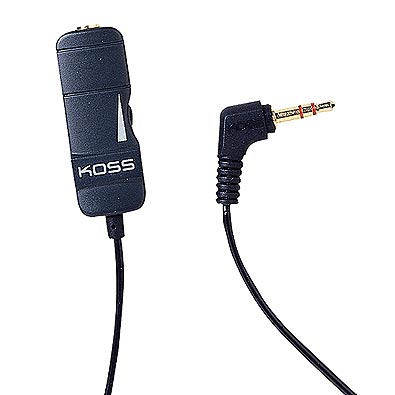

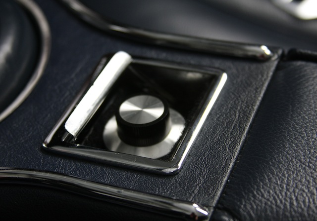

Your audio installation is excellent, and I really like your youtube vidéo. I m looking for an external hidden volume control for my IPod. I Will probably hid It in the cigar trash. I like your butom volume . What is It ?
I Will probably use creative speaker linked to my IPod, now I m looking for an external ipod charger and controler (volume, play, stop,...) ...

A simple inline volume control can be found at places like Radio shack. Here's a couple photos of the inline style I'm referring to. 3rd and 4th photos are my set up.
If you want to hide a potentiometer in the ashtray like I did, you'll have to splice into the self powered computer speaker wires. You'll also have to cut an opening in one of the sides of the ashtray for the wires to get to the potentiometer, and figure out how you're going to screw or rivet the potentiometer to the ashtray to keep it in place. I bought my potentiometer and volume knob from Radio shack. I'm sure you can find other places that sell them too.

Roger, I thought the Cruise Control switches were supposed to go in the ashtray??
