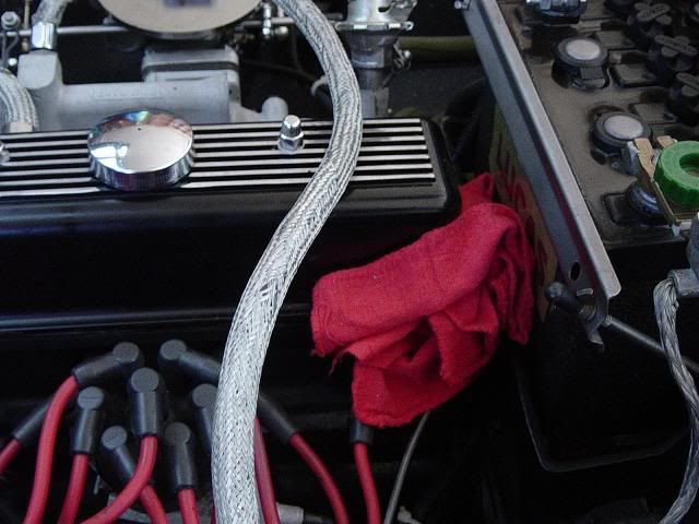

Ok Paul I think I stopped the leak...lol
I know that "leak control device" has a specific part number at Moss or TRF. Do you happen to have it handy?
