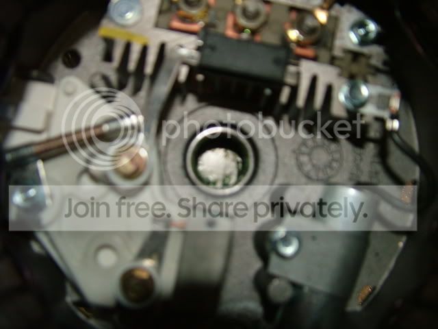

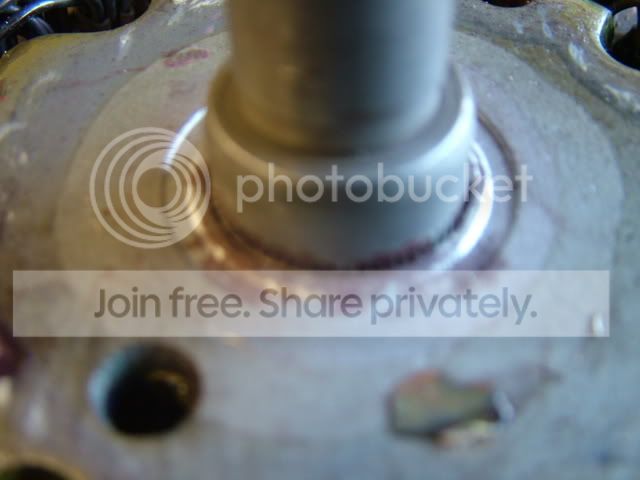

Don,
The rear end of the rotor shaft rides down in the red grease as shown in the second picture of my previous post.

Give me a picture of the fan on the front and the front of the case without it, if possible.
EDIT:
What is that thing sticking straight up from the capacitor on the right side below the rectifier bridge? It looks bent over, like something was forced against it.
And where is your brush holder? Actually, I see it, but where is the retainer holding back the brushes?
Don,
I'm trying to get a clear view of what appears to be a rivet head sticking up from the capacitor on the right. That should be a hex head bolt holding it down. I've downloaded your picture and blown it up, but it's just not clear enough.
If this is an optical illusion, forget it.
If whatever that is, is higher than the brush holder, then it will be hitting the rotor winding as is settles into the case and will cause a bind.
Let me know.

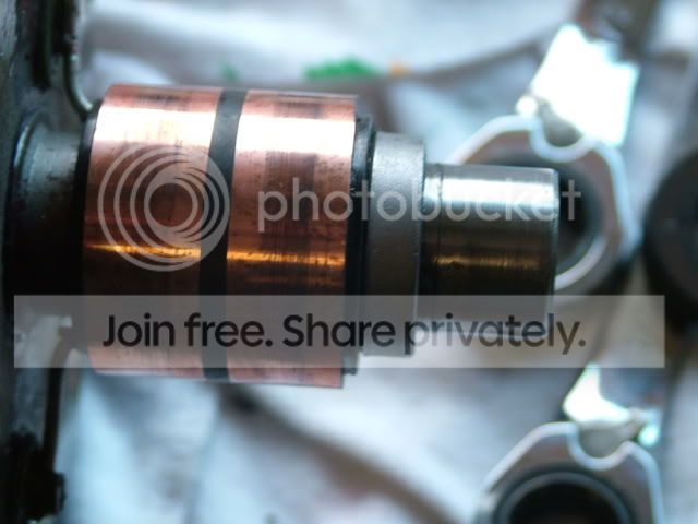

In the picture of the rotor, there is a spacer at the back by the slip ring. Take that off, it shouldn't be there. It is one of the spacers for the drive end. It looks like the one that should be on the OTHER end of the rotor shaft. There is also another spacer that goes between the bearing and the fan. IIRC the thinner one is on the fan side. In other words, there is a spacer on each side of the bearing in the front plate.
Art,
Do you mean like this (with cup bearing moved back, no spacer)?
That's exactly what I mean. There should be NO spacer back there.
Edit: I hope that when the two halves were screwed together initially, the force didn't move the slip ring down toward the rotor body. It doesn't take alot of force to move it. If it moved, then the brushes won't line up with the two segments on the slip ring. If you can wait until tomorrow, I can get a measurement at work. (I work for an electrical rebuilder) That slip ring could probably be pried up with a couple of screwdrivers if neccessary. The position isn't super critical. The brushes just have to ride on each segment.

After another close look at the rotor, it doesn't appear that the slip ring moved. When they move, the two wires attached to it get kinda bunched up. Yours still look like they are OK.
The bottom bearing never came off. It slipped down to the bottom of the shaft and when I installed it, it went to the location it is now.
Paul- The brush retainer is a finish nail installed from the back side,you can't see it.
Art- What the heck is a slip ring?

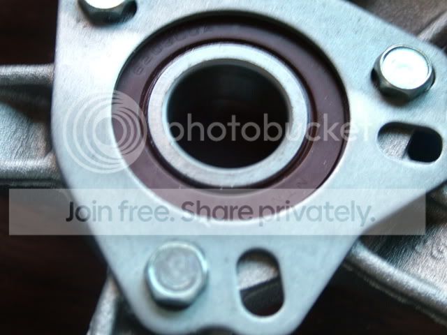

The slip rings are the copper rings in the second photo from the top. They are the electrical rings that the brushes must ride on to make connection with the winds in the rotor. The steel shaft is the same size on both sides of the slip rings and the spacer is to the right of and touching the black insulator the slip rings are mounted to. The bearing is in the housing in the third picture. It is a needle roller bearing.
