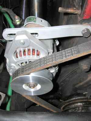

I installed a modern alternator and I still use the thick belt. The stock pulley does fit well to the alternator shaft. For racing purpose I replaced the stock pulley with an aluminum one that I've done myself on a lathe - still for the thick belt.
Hope this helps!
Cheers
Chris

MadMarx said:
I installed a modern alternator and I still use the thick belt. The stock pulley does fit well to the alternator shaft...
Some of the earlier lower output (35-50 amp) Nippondenso alternators have a 15mm shaft which is the same size as the TR generator shaft.
Looks like a great fit, Chris, much better than the big old Ford I used many years ago. Do you happen to know what original application it came from?
