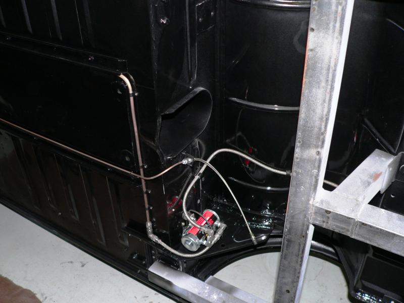

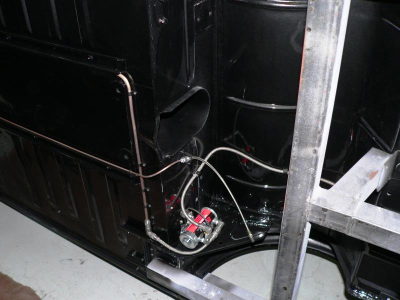

I Don't know about Airtex, but I installed my Facet this way.
I mounted my Facet on the driver's side inner front wing. Picture doesn't show it, but I also had a rubber damping block under the pump to minimize the 'clicking sound" it can make.
By the way, I paid about $38 for my Facet cube pump from aircraftspruce.com
Edit: photo above is the pump mounted to my TR6.

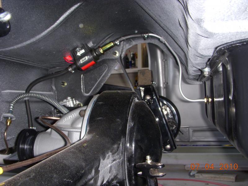

On the Whitephrog the SU fuel pump is mounted in the rear. See photos below.
You could move the pump further toward center if needed to clear shock . Being that I wasn't using leavers, I kept it closer to the out side. I like to keep the pump close and below tank to enhance the siphon effect to the pump whereby causing less strain to pump.
