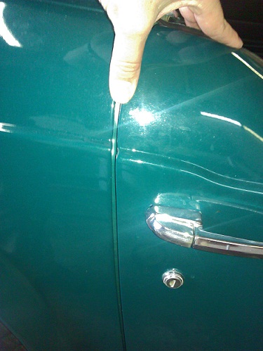

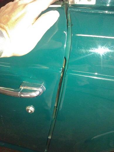

Make sure the panel gaps in the doors are the same at top and bottom. A weak frame will cause the car to sag in the middle.
If possible get the car on a lift where you can really examine and "hammer" on the frame especially the TA attachment point that PB mentioned and the Tee-Shirt area which can hide a lot of rust. After that look for any sign of exterior body rust because if you can see a small bubble, chances are there's a lot you can't see. door panel gaps.........well mine have been the same for 15 years: very even along the front edge and very uneven along the back edge..........and I've got a very solid frame. In my case it's probably more a sign of body mounts needing to be replaced.

On the gaps at the rear of the door, they are normally wider at the top then at the bottom to allow for frame flex. Anything over 3/8" is of some concern.

Here are pictures of the door gap on drivers side. I am concerned about the driver side door.
This gap seems too great to me... thoughts?

Not unusual gaps. None are quite the same. Seen more with gaps like that than not. Not much quality control on panel fits.
Re: Advice on TR6 potential purchase - Pictures
:eeek: Marvin must not have looked at the picture on the previous page..
RE: pic #1. That would concern me, too... Yikes!
The door was closed, right?
