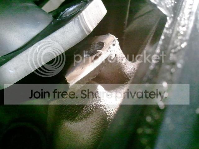

The pickup tube goes from the bottom of the block down into the pan. Had one once where the engine builder put the pickup tube gasket in so that only one bolt was attached properly. The gasket covered most of the hole, didn't seal at all and the pump just kept sucking in air. Ever since then, I make sure I take care of the pan and everything under it.
Oh, that tube.
I did have it out
I sent it to the local machinist guy and he put it through his colossal parts washer.
Remember putting it back with a new gasket and both bolts and nut on the screen

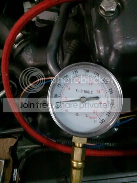

OK, so spun the motor and it sounded like the starter wasn't hooking up with the fly wheel.
Sounded Like it was just spinning.
Brand new starter so I pulled the wires on it and rehooked them.
Same thing , this time I noticed the oil gauge was quivering.
Hmmm. Must be how these hi torques sound .
Spun it for a couple of seconds and the pressure rose to about 20-25
Did this 2 or 3 times and I think I'm good on this account ,I think

I have never used this technique. Even after a full engine rebuild, I just use the starter to get it going with the spark plugs out. Within about 30 seconds or less, the oil pressure reads where it should just on the starter motor. This tells me that the pump is working fine.
