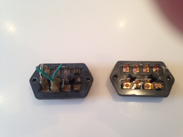

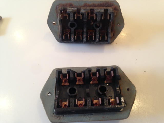

OK Citric acid.
Picked this up on another forum and bought some concrete etch at the store as it was on sale.
24 hours later - should have taken a "before" but, it looked like the not cleaned one.
Looks brand new!

threw it in a tub and let it soak overnight - then just rinsed with water.

some poured out of the bag and add water. seriously. probably 2-3 tablespoons and 2 or so cups of water.
