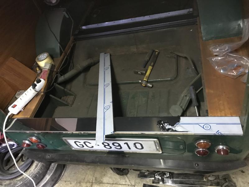

As the the floor panels was full of dents I just cover them with stainless steel...

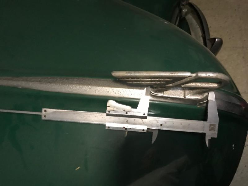

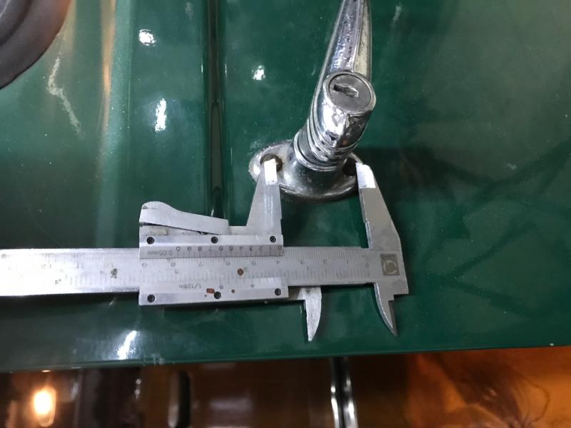

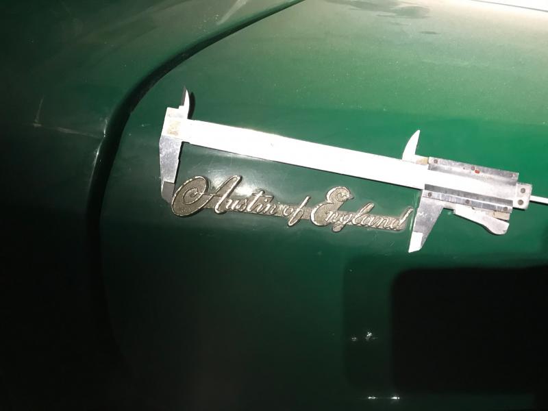

I have beguin a research for chrome items in bad shape nearest workshop who rechrome is 2000km away at mainland...

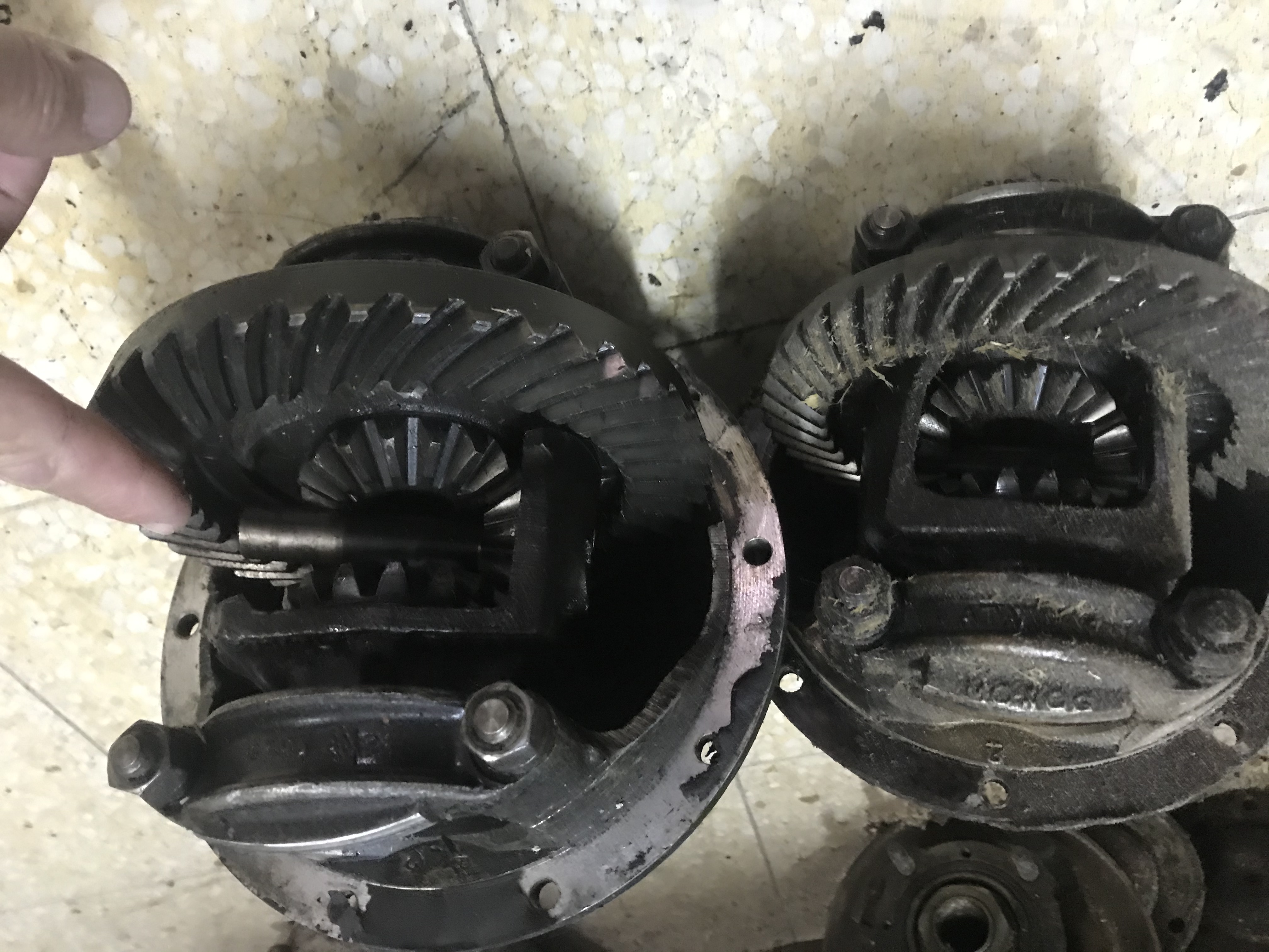

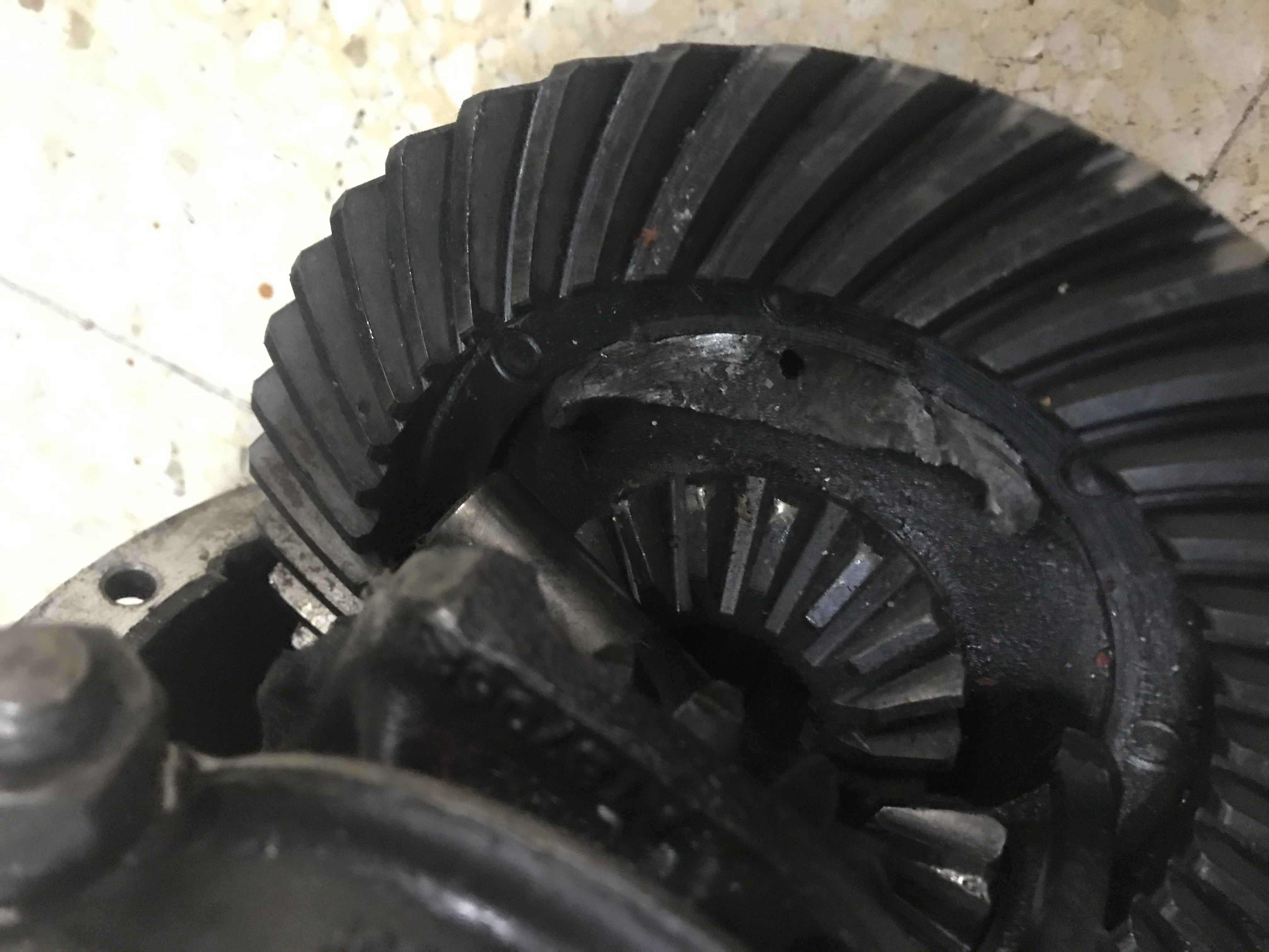

I need a to find an second hand differential as the one in my old A40 is totally broken, I have been searching around a bit but I’m not really shore witch other cars share the same one as there is just one Countryman in the island where I live.
Would any A40 Devon/Dorset differential fit? The cars might have a different final gear ratio but would probably work. I knows the cars had mechanical brakes at the rear which probably does not carry forward to anything newer.
The later A40 Somerset has the hydro brakes for example.

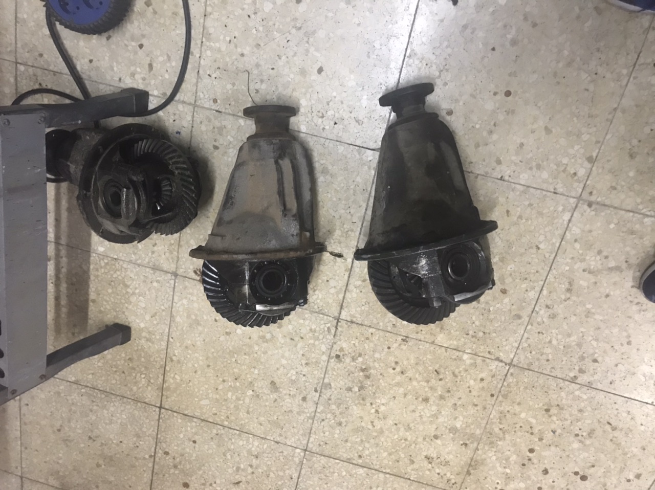

You can see at the righthand side the broken differential from my A40, And if you compare this with the smaller A35 unit you can observe the missing parts

went to pick up the diff this afternoon that I found at the island (5km from home).
And yes it’s exactly the same as the one in my car.

I cleaned the diff today and had a close inspection at it, Doing this I discovered that the splines is not the same as on the oem diff...
The solutions I find for this is:
1. Swap the whole rear transmission
2. Try swapping just the Morris drive shafts to my transmisión
3. Combing old parts from my diff putting this in the “new” unit. I don’t like this one as my unit is very worn sprockets.
I will try 2” option first..

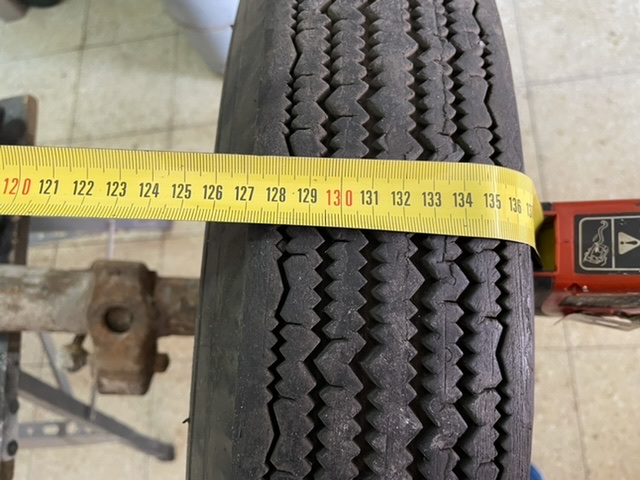

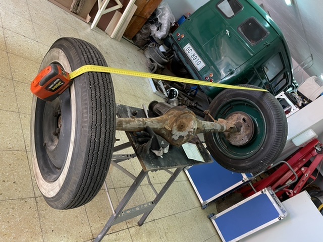

Finally I bought the complete rear axle from a Morris Oxford diesel, the Oxford rear axel is 39mm wider than the A40 unit but it will fit as there good room between the tyres and rear fenders.
