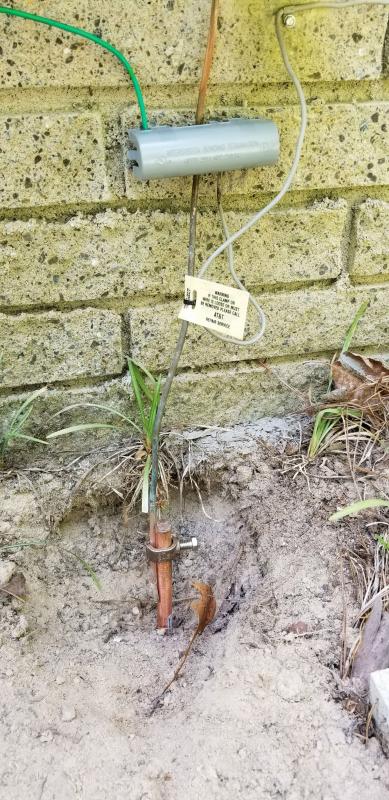

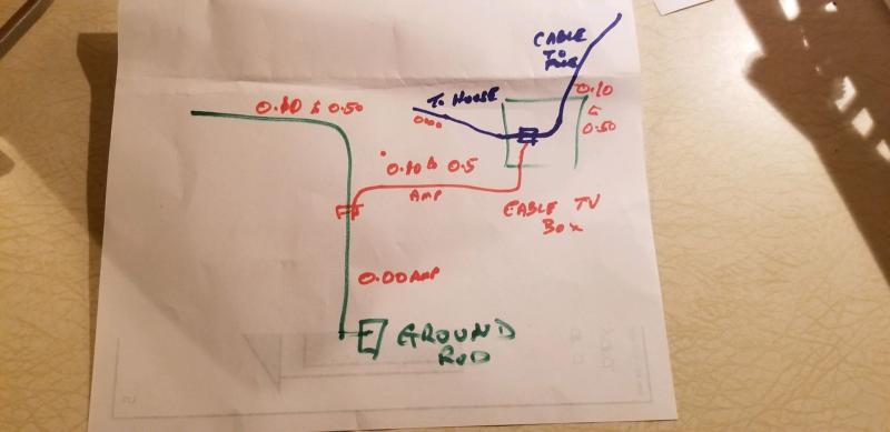

So this evening I went outside to my ground rod with an Amp clamp meter and checked it. 0.00 on the ground wire. Good. But when I clamped on ground from the cable box I got 0.10 to 0.50 amps. Clamping the meter above the cable connection I got the same reading. I also got the same reading if I clamped around the incoming cable wire but nothing on the cable wire after the ground connection.
In my investigation I did find to my horror the ground wire was not connected to the the ground rod. Not sure when that happened but the Phone box ground wire was just stuck along side the main ground. I have vice grips clamping the ground rod and wire and will be getting a new clamp in the morning.
Any thoughts on the cable amps???
David
The green line comes from the main panel. The Blue line is the TV cable line and there is a connector in the cable line with a ground connection.
I will try to address a couple of things.
First where is your main breaker? Is it in the circuit breaker panel or outside at the meter?
Second VERY IMPORTANT! Turn off the main before you mess with the ground rod clamp. You can become a path for the neutral load and get killed. Other conditions would have to be present but it has happened. A code change several years ago requires a ground bar outside near the ground rod. The reason was that communication workers were previously loosening the ground clamp to stick their ground in. On my own brother’s house the cable guy did just that. There was a bad neutral connection at the service connection and all his electronics were put in series and fried. The cable company bought him all new stuff.

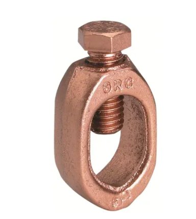

Ok, if the main is In the breaker panel then the neutral and ground bars should be connected.
if you have access to the ground wire outside it’s a good idea to add one of the ground bars that I pictured. It’s a requirement today and a good idea. You don’t have to disturb the ground clamp it simply clamps on then all the other utilities can put there grounds on it.
please remember if you’re replacing the ground clamp to shut off the main.

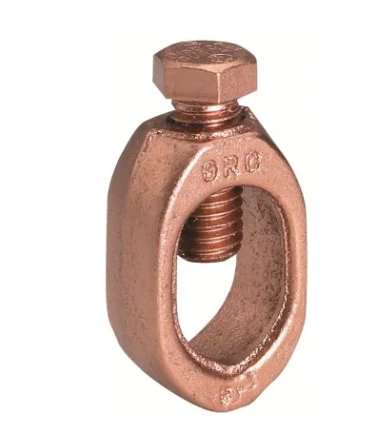

The clamp on my rod is an aluminium clamp. It will be replaced with the type you show in your post.

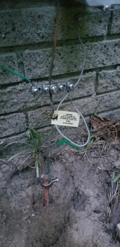

Got a new ground rod and clamp from a local big box store. Would you believe they sell a 5/8" rod and 1/2" clamps??
A bit of cleanup with a file had it fitting fine. Did not need to clean much out mainly flashing from the casting. Added the grounding bridge.
I still have the 0.20 amps when the cable ground is connected to the bridge. It is not there if the cable ground goes straight to the ground rod and there is 0.00 if the main ground wire is connected to the ground rod by it self.
I will screw the bridge to the brickwork tomorrow.
Looks correct now. The only thing is I have always put the ground wire in the V opposite the bolt. It looks like you have it on the bolt side.

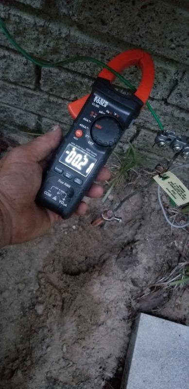

David - do you still get the .2 amp reading?
I do still get the 0.20 amp reading on the cable ground wire but not between the Bridge and the ground rod. It seems to go the other way.
My neighbor said the small amperage is normal on the cable side. Said the cable needs some power for the signal.
David
