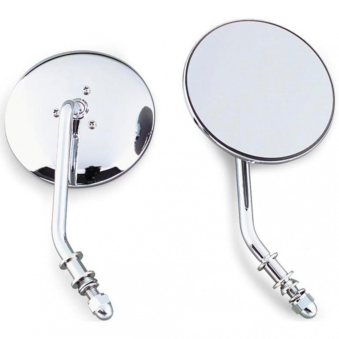

John Timms of BCC presented a Healey door mirror idea for pre-BJ7 models that I thought was both creative, practical, and should be shared. Wanting side door mirror without having to drilling new holes, John inserted round chrome Harley Davidson motorcycle mirrors into the forward side curtain mounting hole of each door to provide an easily adjusted rear view that can also be quickly removed without evidence. According to John, these $25 mirrors appear period correct, fit perfectly into the side curtain mounting holes, and come with height adjusting shims and acorn nuts for retaining adjustment settings. For the non-farsighted Healey owner who has difficulty setting or seeing through their Lucas wing mirrors and doesn’t want to drill new holes, these seem to be a great solution.

Have one of those Harley mirrors on my Bugeye -- replaces the front-most screw holding the windshield on. Handy things. Really, there are lots of motorcycle mirrors that can work (the thread is pretty common), but these definitely work.

John confirmed that the cowl curve accentuates the angle of the mirror arm as mentioned and also indicated the Harley Davidson link you provided are the same mirrors he has installed.
