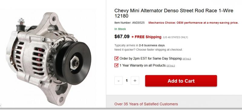

I got My bracket from J & N Electric in Cincinnati. They couldn't rebuild My generator because it detonated too big and suggested the bracket and a 35 $ 10 si. Works good, I am however neg. ground.
Steve, what kind of alternator are you mounting?
Been running this one for around 10 years:
