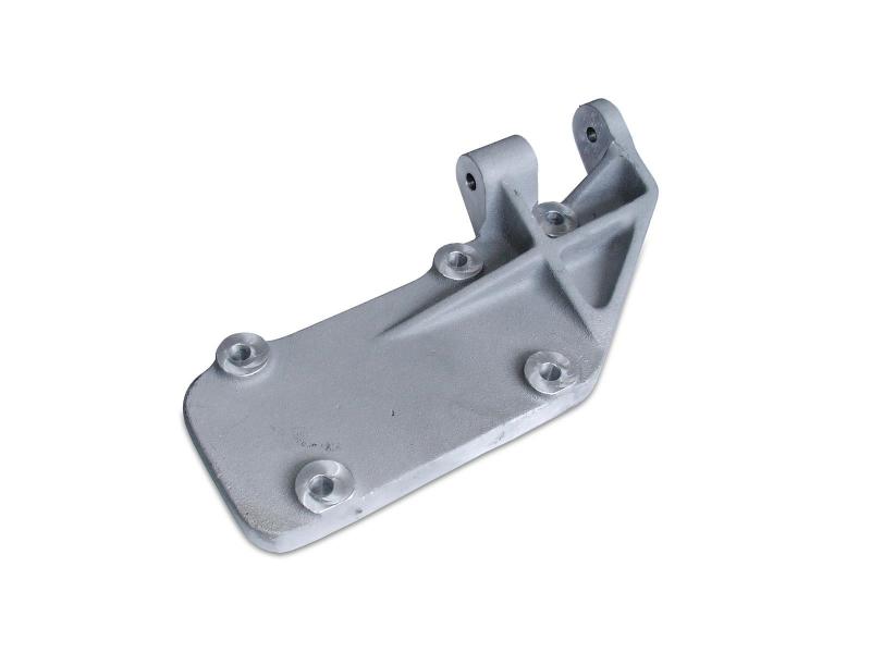

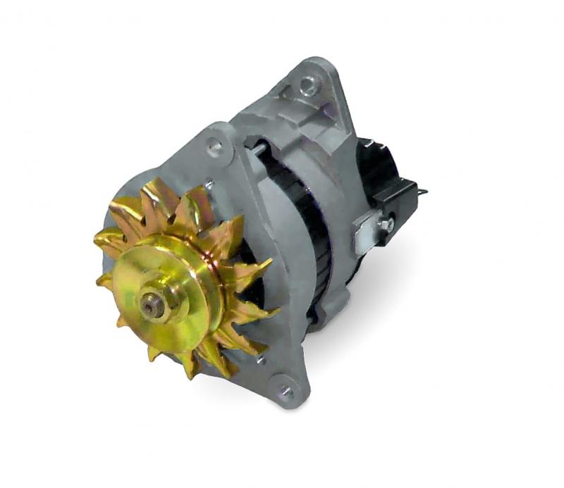

Hello All,
Has anyone had any experience with the alternator bracket from A H Spares? It's available from both A H Spares and Moss as part of a kit including a Lucas alternator, but the bracket alone is available from A H Spares (for a lot less money). My concern is whether it is designed such that only the Lucas alternator will fit, or if a U.S. manufacturer (Delco, etc.) will work as well. Pictured is the bracket and the Lucas alternator, both lifted from the A H Spares, LTD website.

Hello Dog, I'm not sure but I think that bracket will only work with the Lucas alterantor. I have been running a Delco alternator for about 10 years on my Healey with a lot of driving. ( no problems ). the alternator is around a middle '90s Chevy S10 Blazer vintage. Got the alternator from Napa. The bracket I am using was made and marketed from the North Texas Austin Healey Club ( I think that was their name ). The guy that produced it is no longer around But I think Allen Hendrix of the Hendrix Wheel fame is producing the same bracket.
Hi Vette,
Thanks for the reply. I was thinking it might be a Lucas-only rig, particularly in light of those wide spaced ears on the alternator housing. I have seen the Hendrix bracket, glad to know it's been good for your use. I need to replace the side cover as well and was thinking the AH bracket might work with a Delco, but I'm starting to have my doubts. It may just be best to get a new side cover from Moss and the Hendrix mounting kit.

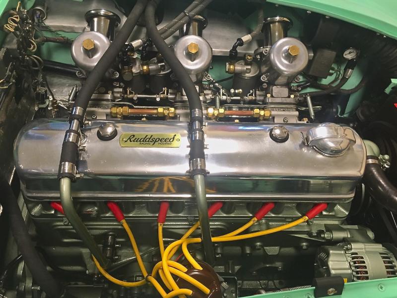

I'm using the AH bracket with my own sourced alternator. I had to make a spacer for it to fit tight.

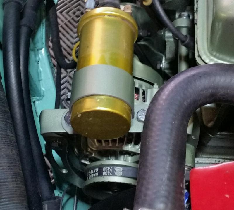

For the cheap version, using the stock side plate, a friend's setup...

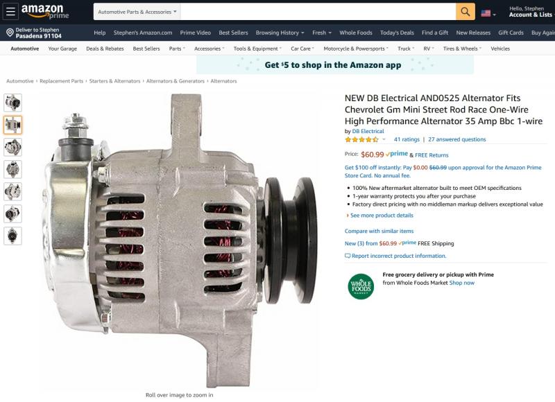

Not to rain on Hendrix' parade, but one can buy the two curved adjustable struts from one of the hot rod suppliers for peanuts. A piece of 5/16" all-thread, some nuts and tubing (to cover the all-thread) finishes the job. Washers form the spacers where the struts attach to the front engine plate. If you have a 3/8" x 5/16" bushing you can bush the 10mm hole to better fit the all-thread.
The curved struts were chromed and too long. He drilled the holes at the bottom, cut them off and painted the setup green. When he painted the alternator, he stuffed pieces of fishtank tubing in the air slots to avoid painting the windings etc.
He made the bracket for the coil, keeping the stock wiring, as this setup's intended to be a spare in case his Dynamator expires on the road.
If you use a 1-wire alternator, be sure to add a voltmeter, as it won't drive the idiot light. Voltmeter's a good idea anyway.
This one will work with the stock side cover but it looks like the GM ears might be a little off for the AHS side cover.
I've been running one of these for >10 years.
