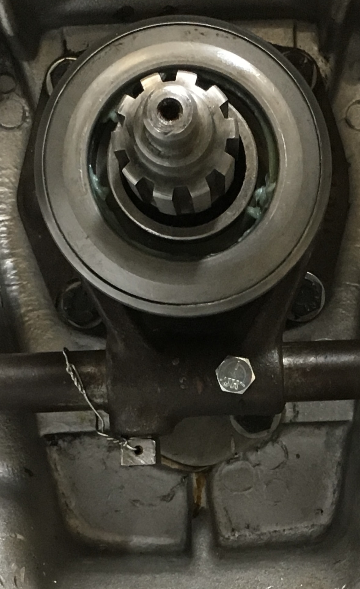

As to cross pin. This is mine done by a uk triumph gearbox specialist.
It’s similar to the factory but in the opposite plane.
Some use a 2 or 3mm roll pin which are sprung hardened steel so very strong.

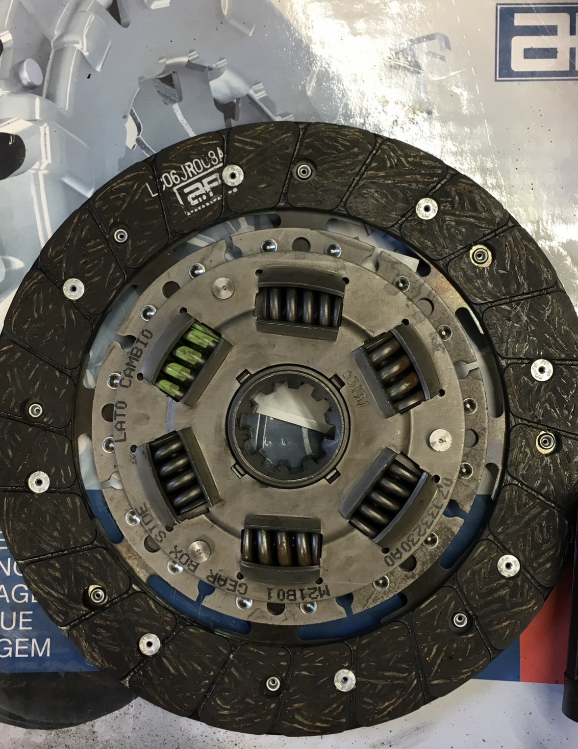

Just checked out markings/ number/brand on what I removed. I bought the car from the original owner and the paperwork file show no clutch work. So, I assume its original -
* Clutch - one side stamped England 53131 - looks like the AP logo. Other side stamped 51580 with "Flywheel side" in both English and German
* Pressure plate (hard to make out) - AP - 4LCKF16005A 543H104 LC 03JR 003B
* Throw out bearing - RHP UK 14/W 2 1/16
Trying to determine the best kit. Inventories are low.
Will
I'd just get any well known, respected make. I used a Borg & Beck kit, but that was largely a random choice. Others might have more experience with these makes, so I'll let them comment.

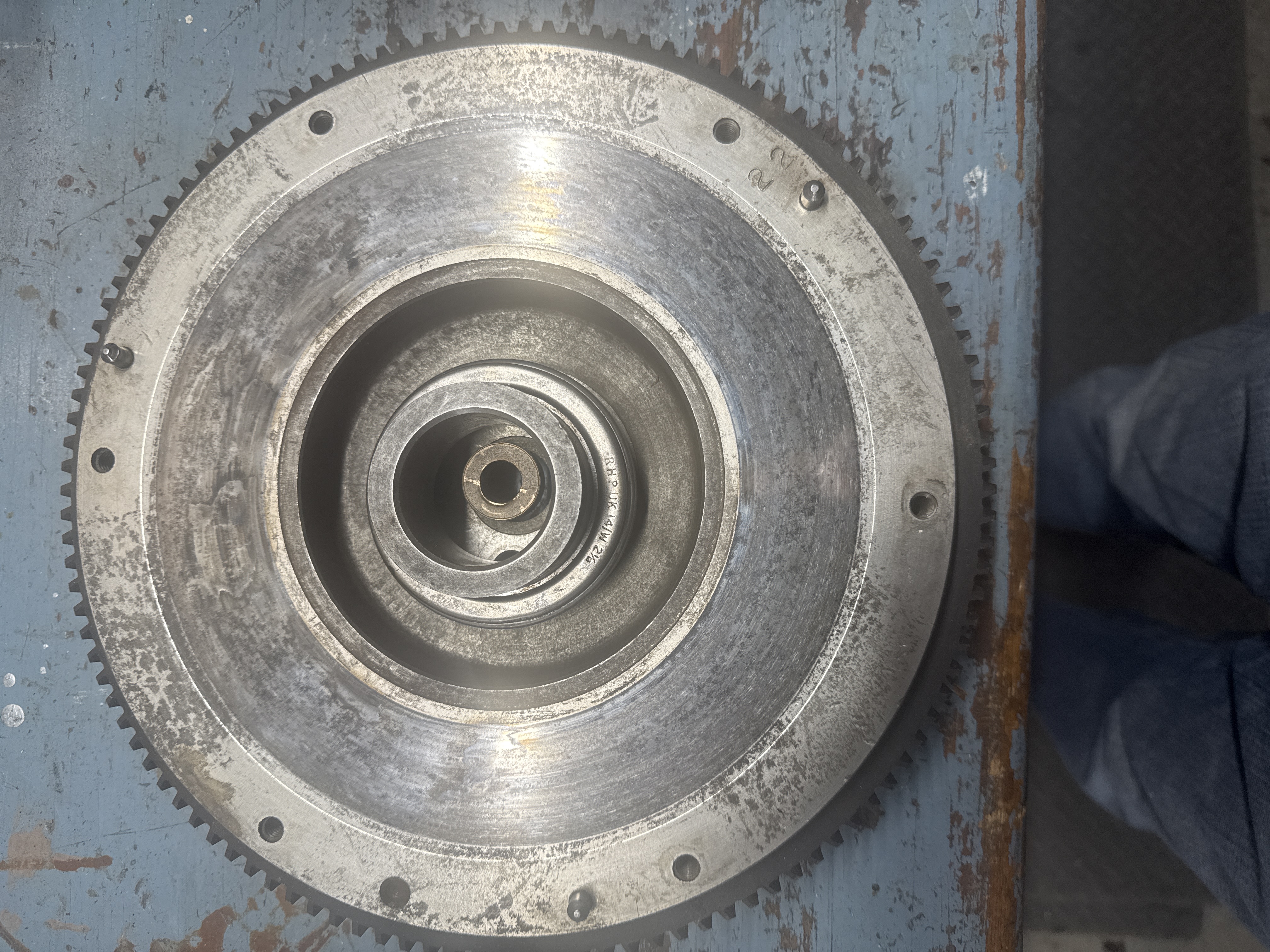

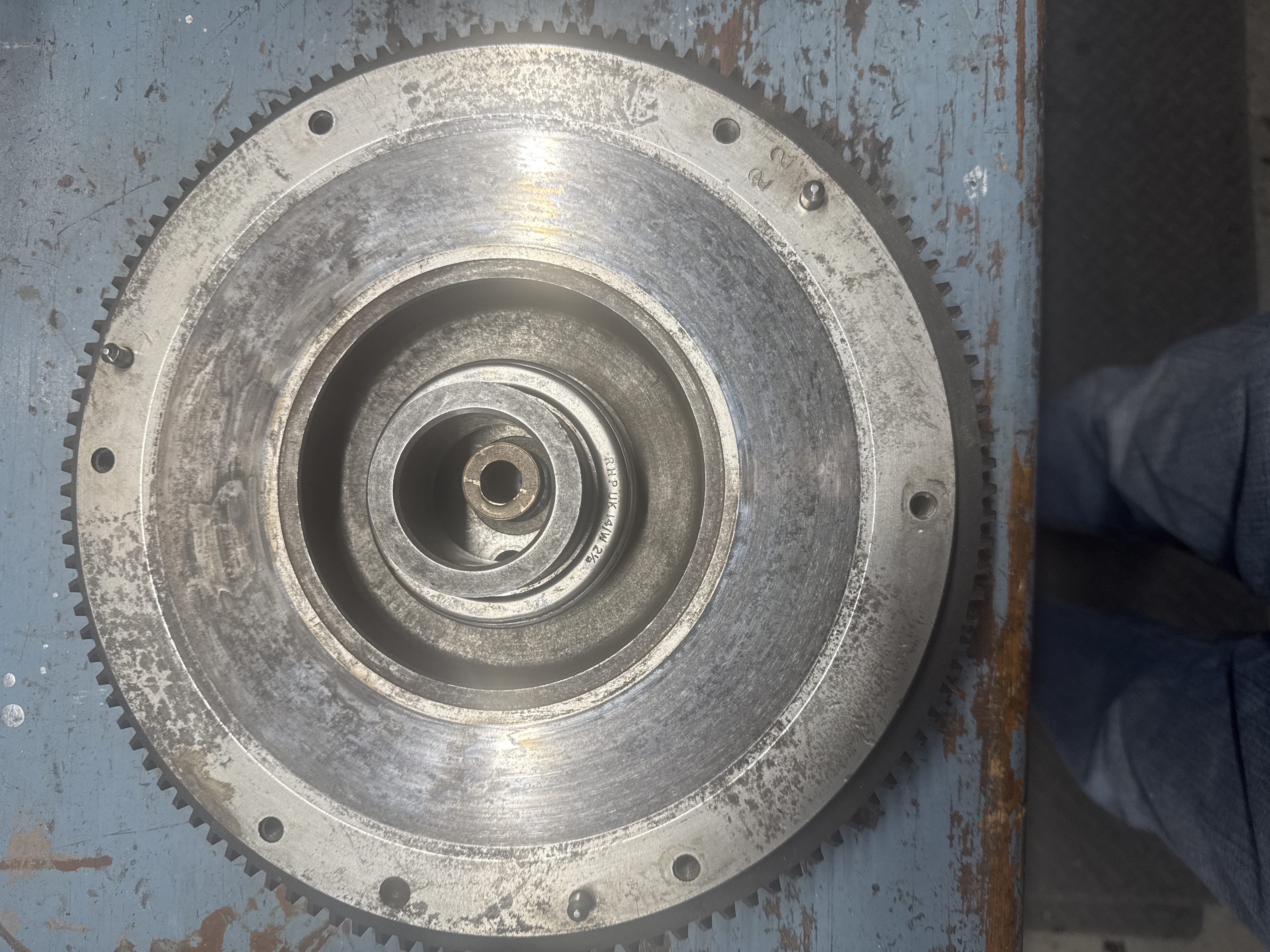

Here’s the flywheel. No gouges but some discoloration. Thx everyone for your time and comments. It’s an education.
Will

Update. Bought TR6 from original owner several years ago. Turns out he had just replaced the clutch and pressure plate before he sold it to me and the info was not in the file. Items have <1K miles so, they’re going back in tomorrow.
1. Going with a new (rebuilt) OD tranny. Would like that 5th gear. With the new hardened taper pin, supplier does not recommend cross drilling for a second pin/bolt through the fork and shaft (not needed and shaft integrity). But, they will if I want. A little confused on this. Wonder if this new pin has solved the shearing problem?
2. Flywheel - looks good. Should the bushing insert be greased?
