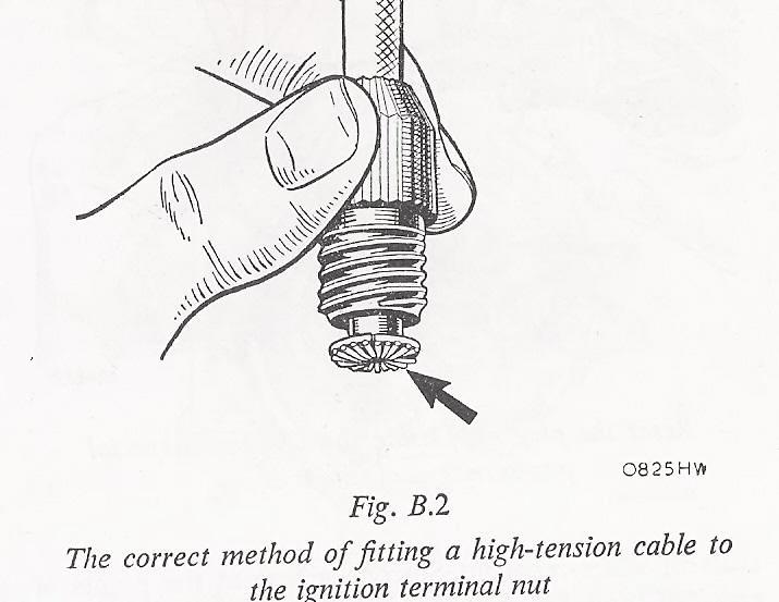

At the time those coils and "washers" were used they were ALL split. And made of brass. The wire was to be put thru the center hole and wrapped from there to the O.D. and held in place by the threaded "cap". The "ring" was like a lock washer: to prevent it from unwinding the threaded cap. I've one on the MGB here, it's not a "low output" or inferior coil, just the way it was connected "back-when."

So, it just needs wrapping? I figured it might since the "wires" are apparently very fine strands of what looks like carbon or something, and the wont take solder! The split washer certainly looks like brass. I think I am missing the "ring" piece.

You have the right plan with the wire: Thread the fine conductors thru the hole and wrap 'em out around the circumference of the washer and tuck 'em back over the other side slightly. The threaded ferrule should have a base JUST the right O.D. to capture the washer and trap it against the coil's (slot-head) electrode. No "ring" piece to worry over.

Julian, that coil was only meant to be used with stranded wire. And, the wire is <u>NOT</u> meant to be soldered to the washer, only splayed back around the area of the washer, as in this illustration.
Jeff

Sorry I got the coil wire attachment wrong. Mine was soldered to a solid washer, but must have been a DPO-ism.
